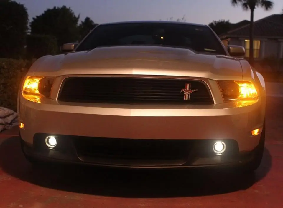

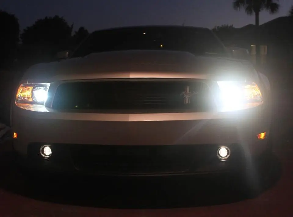

Picked up a pair of Sylvania Silver Star Ultras...H-11. Took about 1/2 hour to jack up car, remove the 9-7mm bolts on the cover to access the lights, but happy with the whiter look. Hated spending so much on the HID's only to get standard bulbs. Dont have a comparison to stock, but you pretty much know how stock ones look. Here's the look after the replacement:

I've got a "standard" GT, and I thought the fog light's yellowish tint looked ugly next to the pure white of the HIDs. So the Silver Star Ultras put out more white light closer in color to the HIDs?

Looks much better!

Those look MUCH nicer! I have the CS valence and the stock bulbs are pretty yellow. Ill prob go pick up these up and do it over this weekend.
