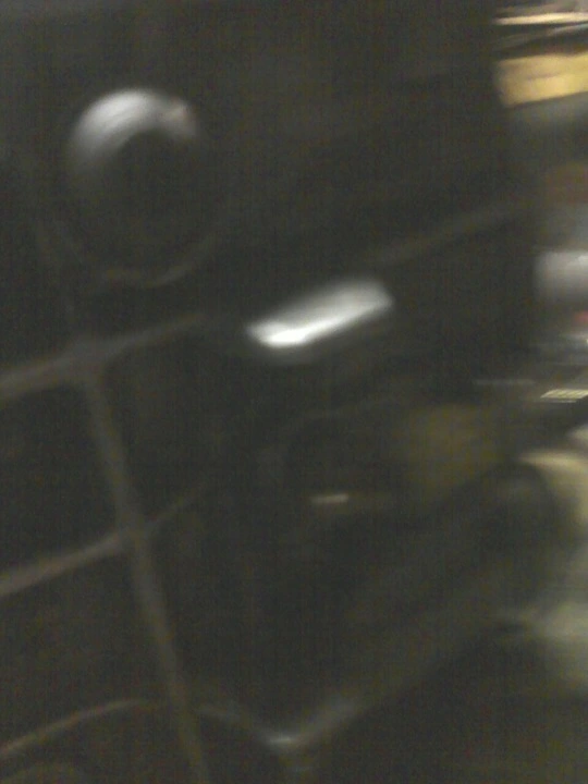

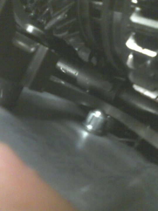

this is what you're dealing with, and sorry for the crappy pictures.
this is an internal shot of your trans. this is the reverse lever on the dr side of the trans. the shaft on the upper right is the bolt you are loosening. this will loosen the entire shaft..you don't want that. Do you see the check ball on the bottom?? Those lock up and seize over time. This is very likely your issue. thread out that check ball, which is the reverse switch...and see if that doesn't fix the issue. All that that checkball does is depress in when you go into reverse. when the ball depresses in, that turns the reverse lights on.
external shot. the top bolt is the one you want to TIGHTEN. the bottom one down and slightly to the right is the one you want to loosen
