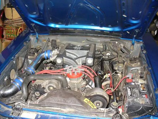

yeah i enjoyed.. ur gonna have to relocate ur map sensor thoe cause the intake sits so close to the fire wall, also i know when i put it all back together my hood would rub the very top of the intake so i had to cut out abit of the ribs in the hood. and yes u can take the valve covers off both sides, but the passenger side one is a little bit of a pain. we had to actually bump the motor abit so that thte back rocker arm was sitting in the right postion otherwise u can't pull it right off
u can see in the pic i just moved it to the right
where did you relocate it
i moved it just to the left so it was more on the passengerside u can see it in this pic sorry its kinda small

I like the way it looks.. its alot different then every other plenuim out their.. but i agree with u if it makes power i like it..I remeber reading awihle back its supposed to flow pretty good very similiar to the holly systamax
