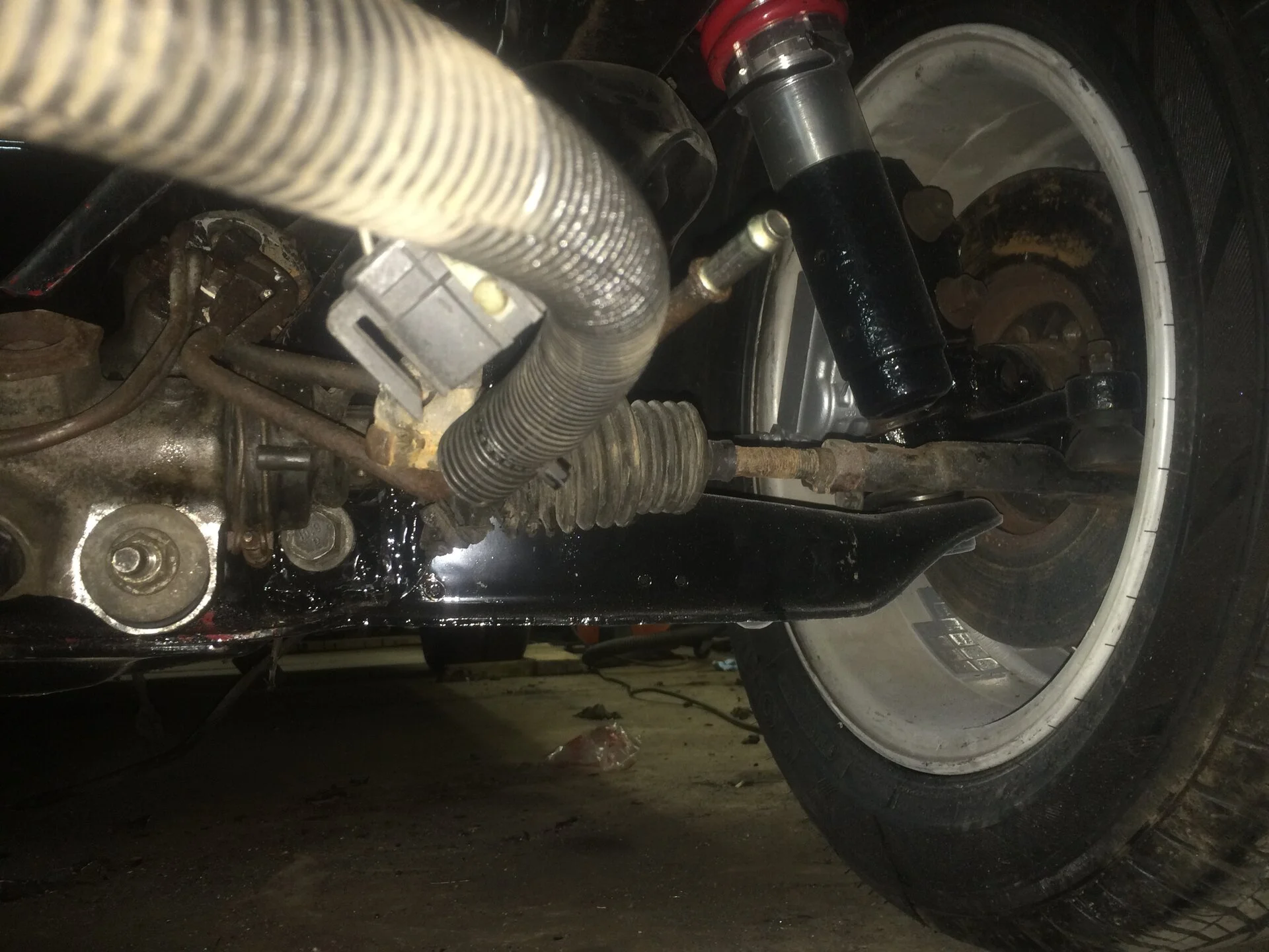

Rim scraping on the control arm
racer_inboston
Feb 2, 2002
310
boston, ma
After lowering the vehicle with H&R's it handles very nice looks great but...I noticed that only when turning my steering wheel sharp to the left and moving slowly like on a 3 point turn, the rim scrapes on th econtrol arm, I actually took the rim off to locate the scraping and the whole inside of the rim has a slight metal scrape with sharp metal pieces stickin gout from the harsh scraping....Any help maybe opinions on spacers or such would be apreciated, also I will be running 245 front and 275 rears, but the rubber isn't whats scraping, the metal lip of the rim is..
tks
Bmorrisj: tks for your responce. Well I'm running the 96 cobra wheel replicas that AFSwheels.com stopped manufacturing, they are 4 lug, and i think they are 8" rims coulod be 7 1/2. and yes I need to put the cc plates that i purchased, just waiting to get my struts so i can do it all at once. the wheels tilt in just a lil bit not bad at all.
Have not heard of that one before...
Have you had the alignment done? If you had excessive toe issues it can change the limit of the travel.. Do you have enough room for a small spacer like around 5mm or so?
Yes I did my alignment, but still scrapes, and no no room for spacers specially when i install my new cc plates after i pu tin the new struts...so where do i purchase this steering limiter N804842-S Washer...
how many do i need?
tks guys
I usually hit the junk yard and pop them off cars. Cut the boots on the rack and pop the C shaped spacer off that limits how far the tie rod can go into the rack. I have two on the '93 because the tire was rubbing the inner fender. Car turns like a truck now though...
Jamie
If it fit before and only now starting to scrap, inspect your balljoint. If it’s loosening up it can shift and cause a misalignment of the spindle to control arm and cause rub
A pic from this perspective can help diagnose..
