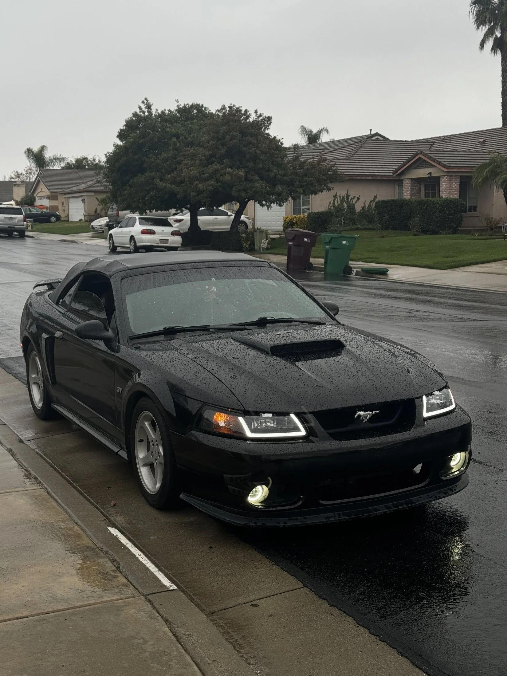

I have a 2003 vert. I want to take it to the track but you obviously need a roll bar. I have one of the “style bars” lying around and I was wondering if I would pass tech with that since it is technically roll over protection. Thanks :)

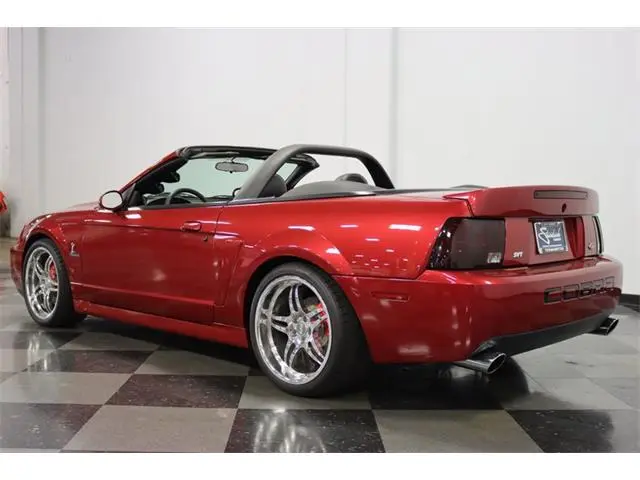

Black car is mine, red car with the bar is what I’m referencing

That "roll bar" on the red car is not a "roll bar" per NHRA.
That is a appearance item.
It actually offers no real protection in the event of a roll over.
Look at the way it is mounted.
It is for looks only.
The style bars (red car) offer no roll over protection and are not considered roll bars by all racing organizations. Sure, they might be better than nothing, but the only have two points of attachment. Any force perpendicular to their attachment points will easily fold that bar down and render it useless. It’s probably cheap 1” OD tubing and doubtful it would withstand the weight of the car.

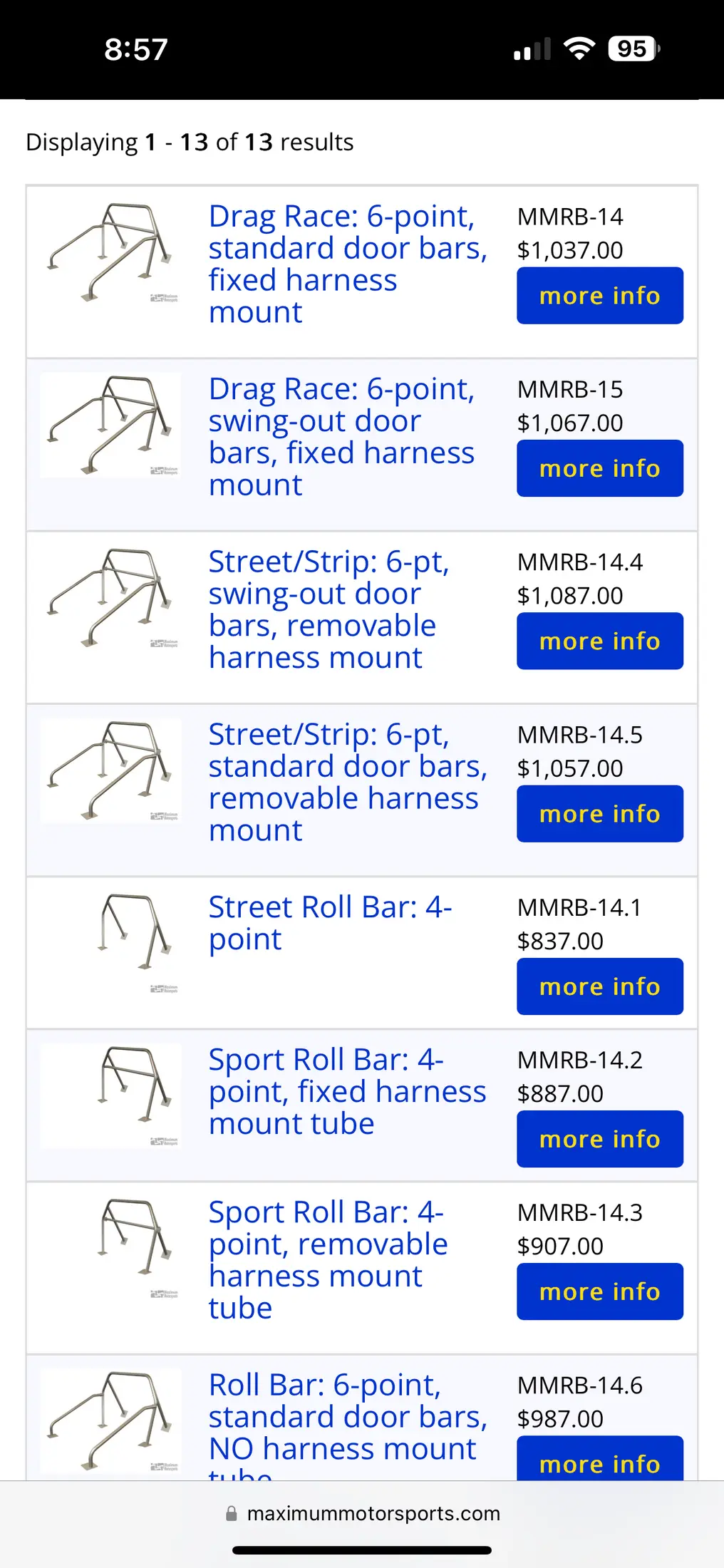

A true roll bar is something like this from maximum Motorsports. You’ll want to do your due diligence as to if they would meet tech at your track. Some of these bars are not NHRA compliant.
