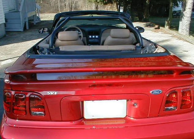

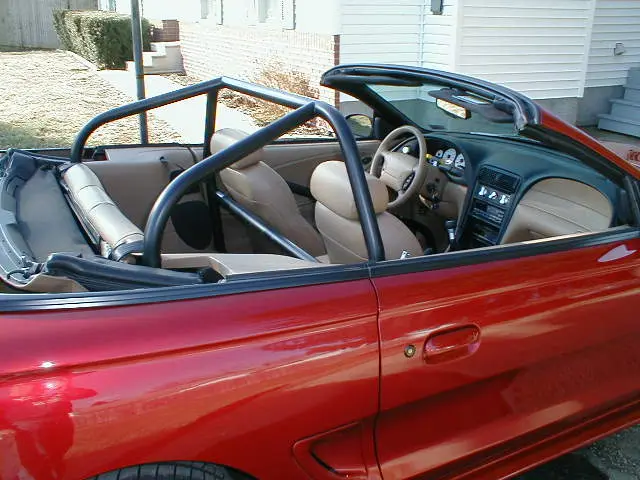

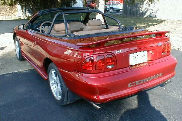

I believe maximum motorsports sell Autopoint roll bars, but shipping would probably be expensive. Might want to call some local performance shops and see what they can bring in. Or find a fab shop. I'm gonna take my car down to Delaware to a place called Rhodes Custom Auto, here's some pics of work they've done..
I like how the rear bars come back and to the outside as opposed to straight back.

First off if you are serious about getting a LEGAL roll bar you need to buy a rule book as its all spelled out in there. But in a nut shell NHRA has required a roll bar in 'verts running quicker than 13.99 and coupes quicker than 11.99, and unless it changed for 2005 IHRA has always required them at 13.49 for 'verts and 11.49 for coupes. You need a main hoop, two support bars from the main hoop that head to the back of the car, a main hoop tie-in that runs behind the seats and acts as an attachment point for the 5pt harnesses that are also required, and at a minimum you need a driverside side impact bar that goes from the main hoop, crosses between the drivers shoulder and elbow, and proceeds down to the floorboard. There are specific tube wall thicknesses, bar placements, angles, etc that need to be followed for it to be legal.
Rhodes does some mighty fine work, I have seen the car in the above photo in person.
