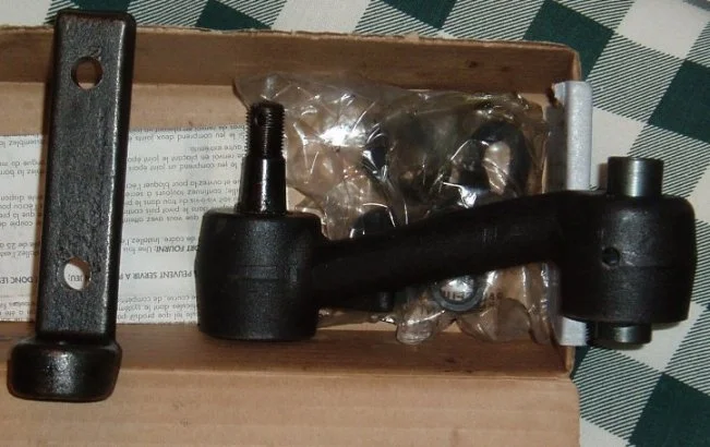

I just bought but have not installed a Moog idler arm for a 67 with p/s. In place of the frame bracket and bushing it now has what could be described as a ball joint it looks and is marketed as an improved design. I will post photos if anyone is interested.

Here ya go.

That's it. Just like the early cars. One bearing kit and your done.
If the shaft on the center link is the same size as the early idler arm bracket, it'll work with a 65-66 roller kit, or find a roller kit for some type of car with that size idler arm bracket.

where did you get the moog piece and how much scratch?

CarQuest IIRC it was around $70 part #K8158
