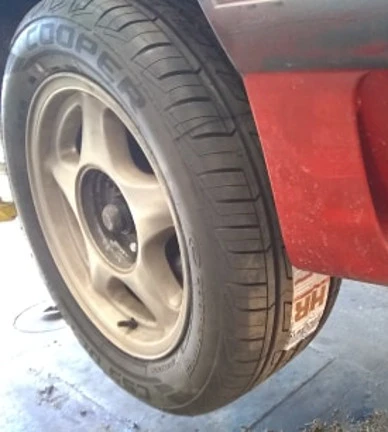

Stock springs, yes, low profile tires no. Tires are whatever size it came on from the factory. Cooper Touring.
A fox with warn out struts, shocks on factory springs and factory height tires is really the softest you'll get in that car honestly.. everything else is geared more towards performance where it stiffens up the suspension more. If you replace those struts and shocks with factory replacements lets say, it'll get a firmer stiffer ride then it mostly is now.
