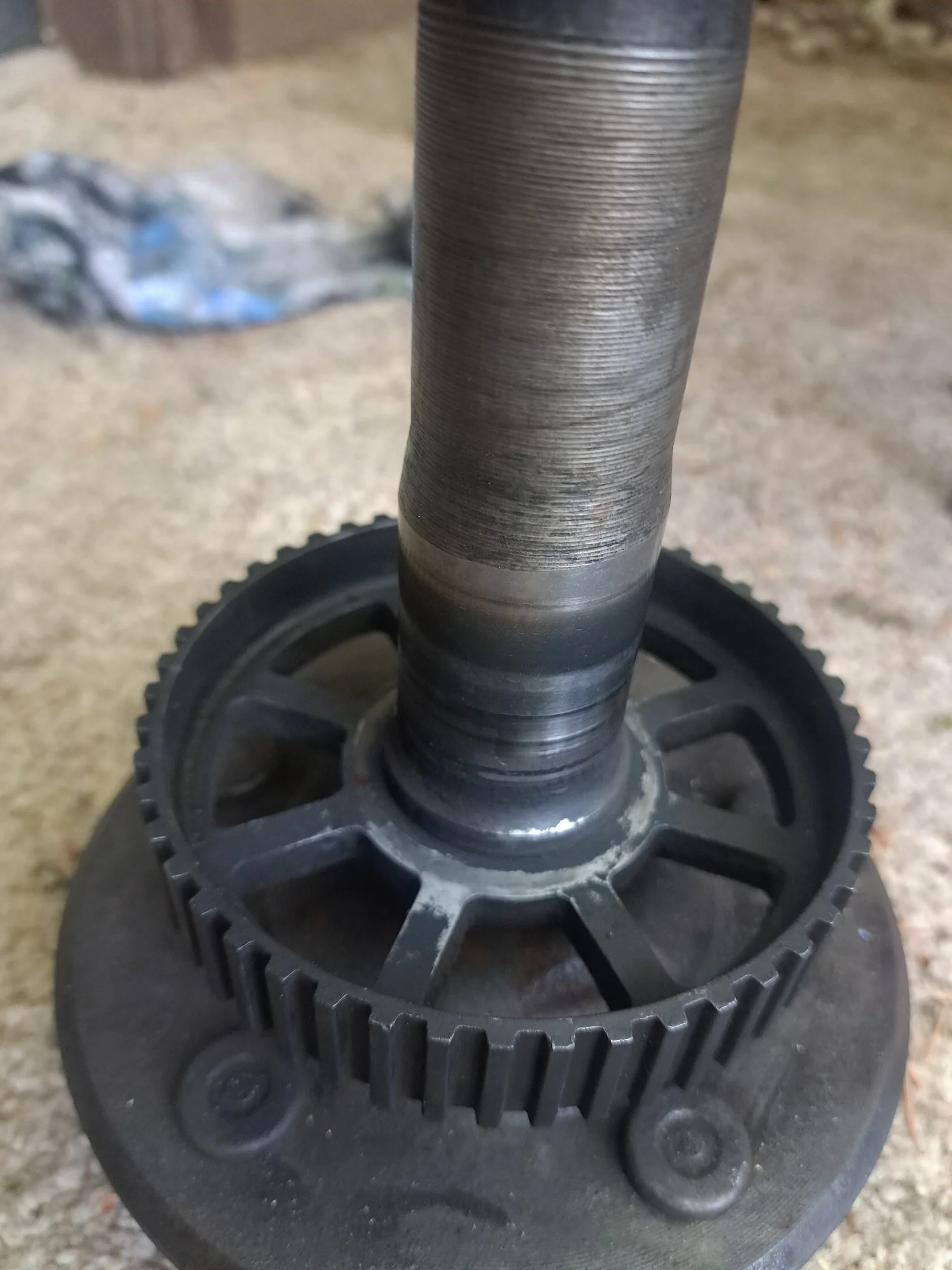

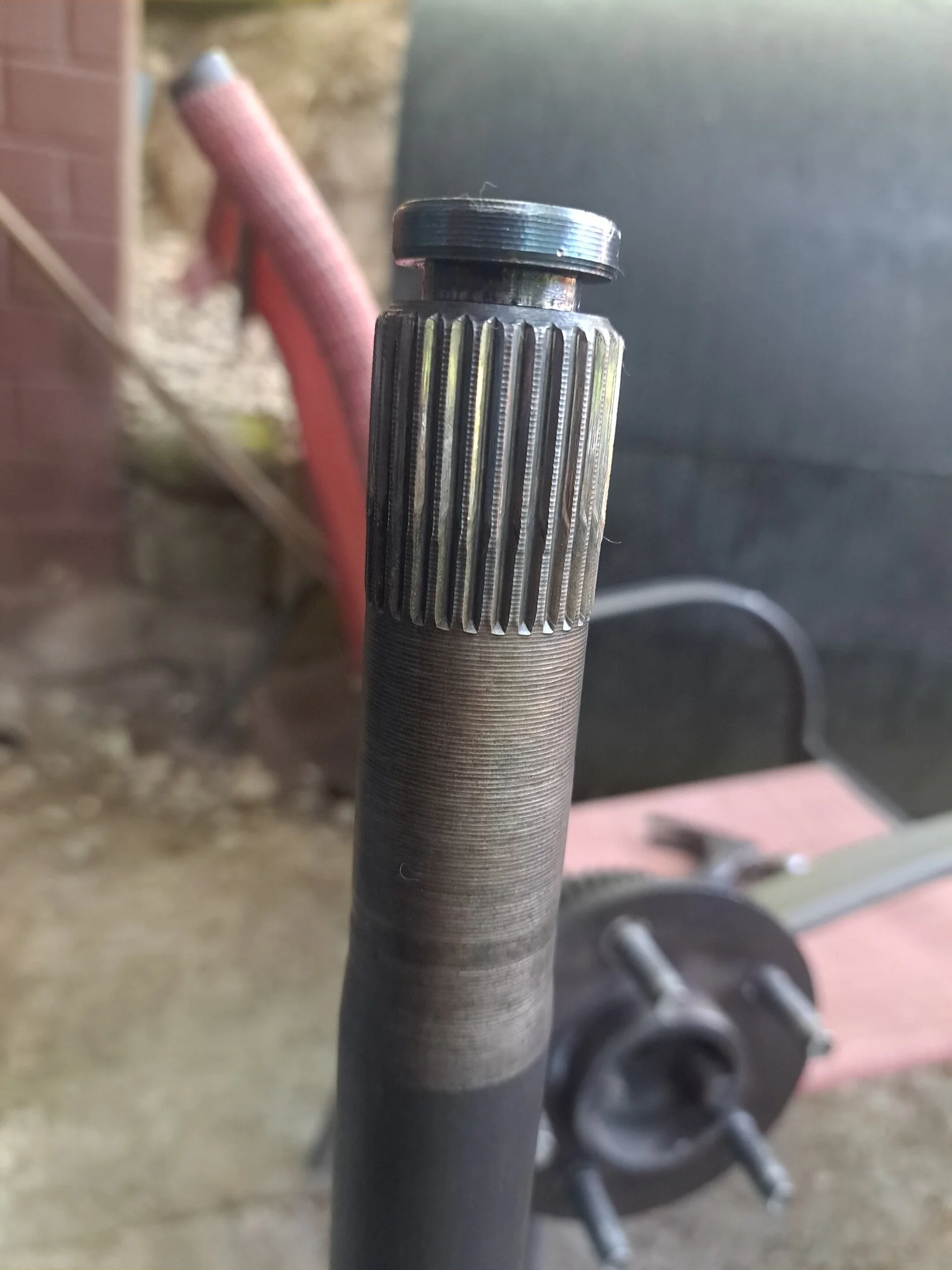

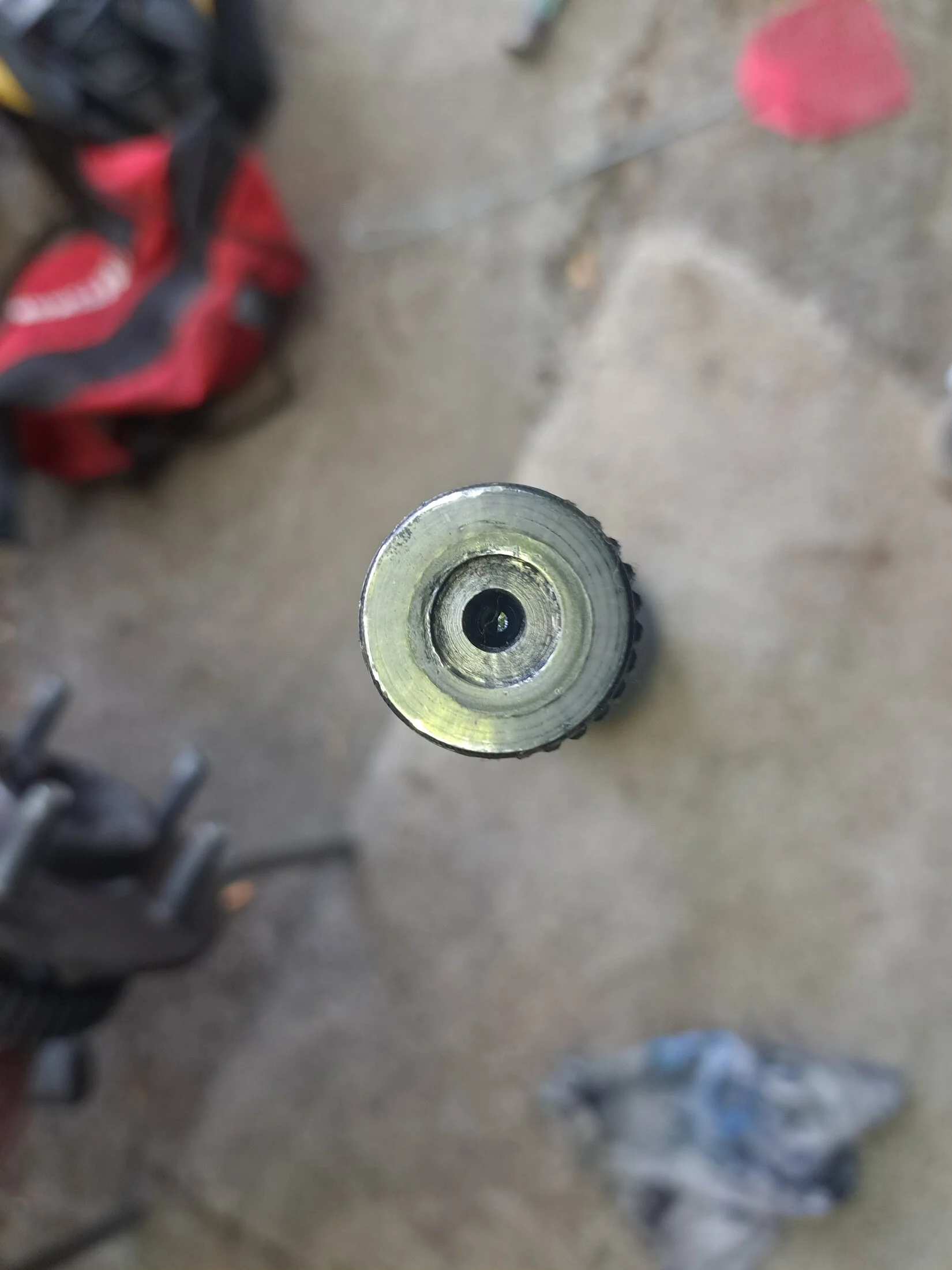

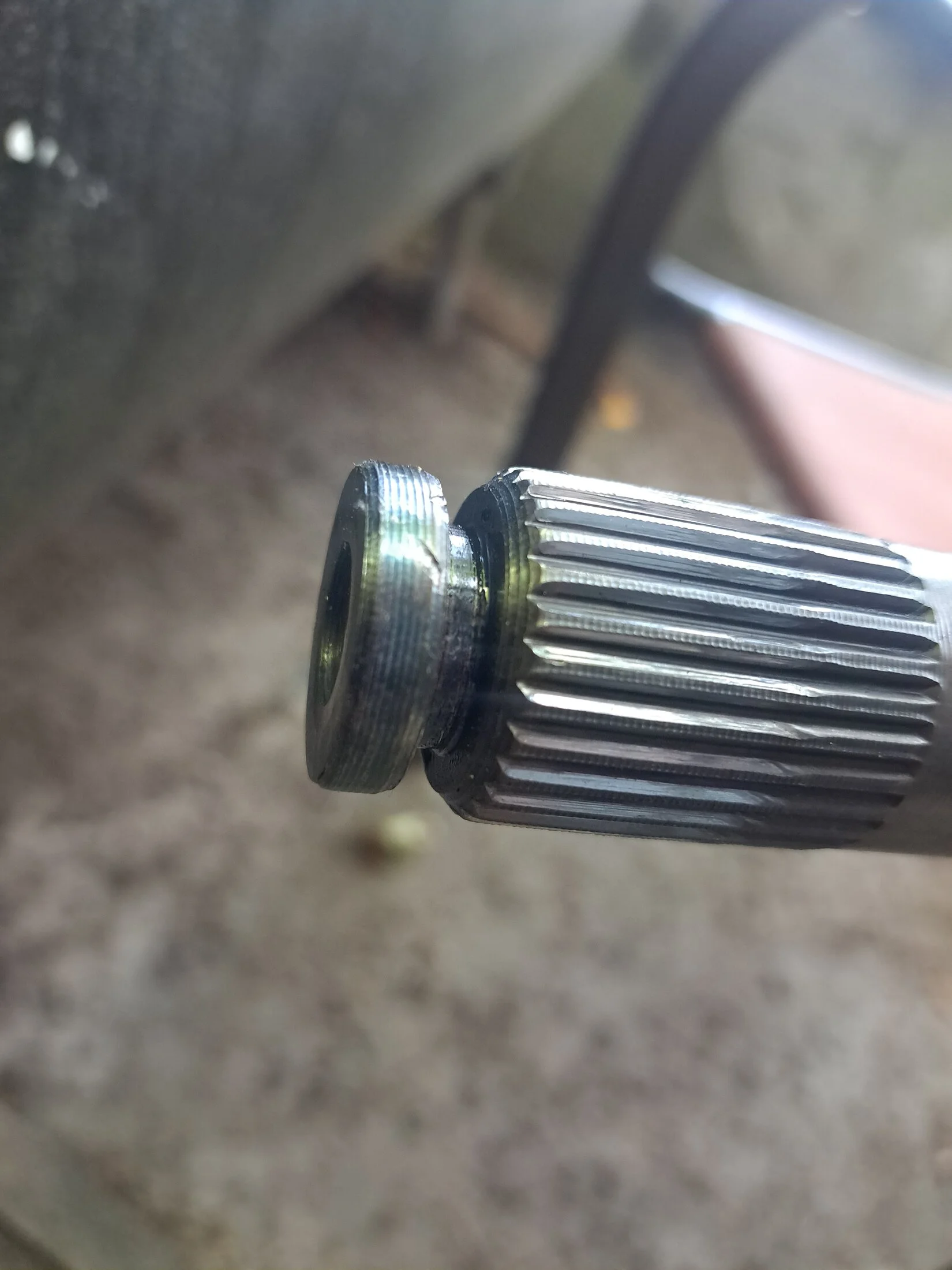

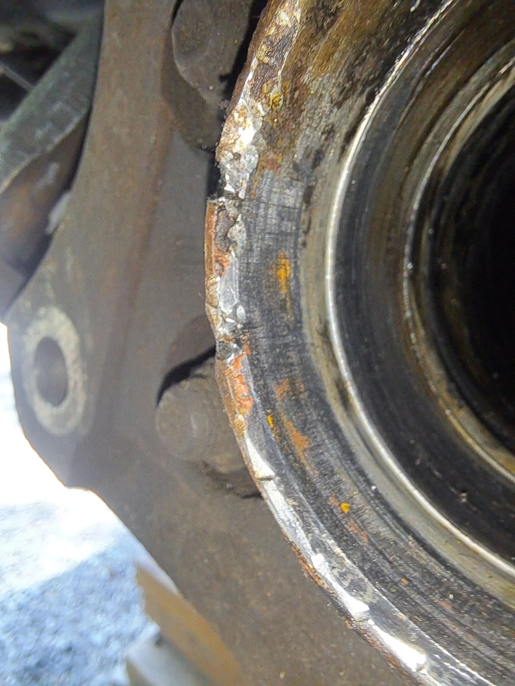

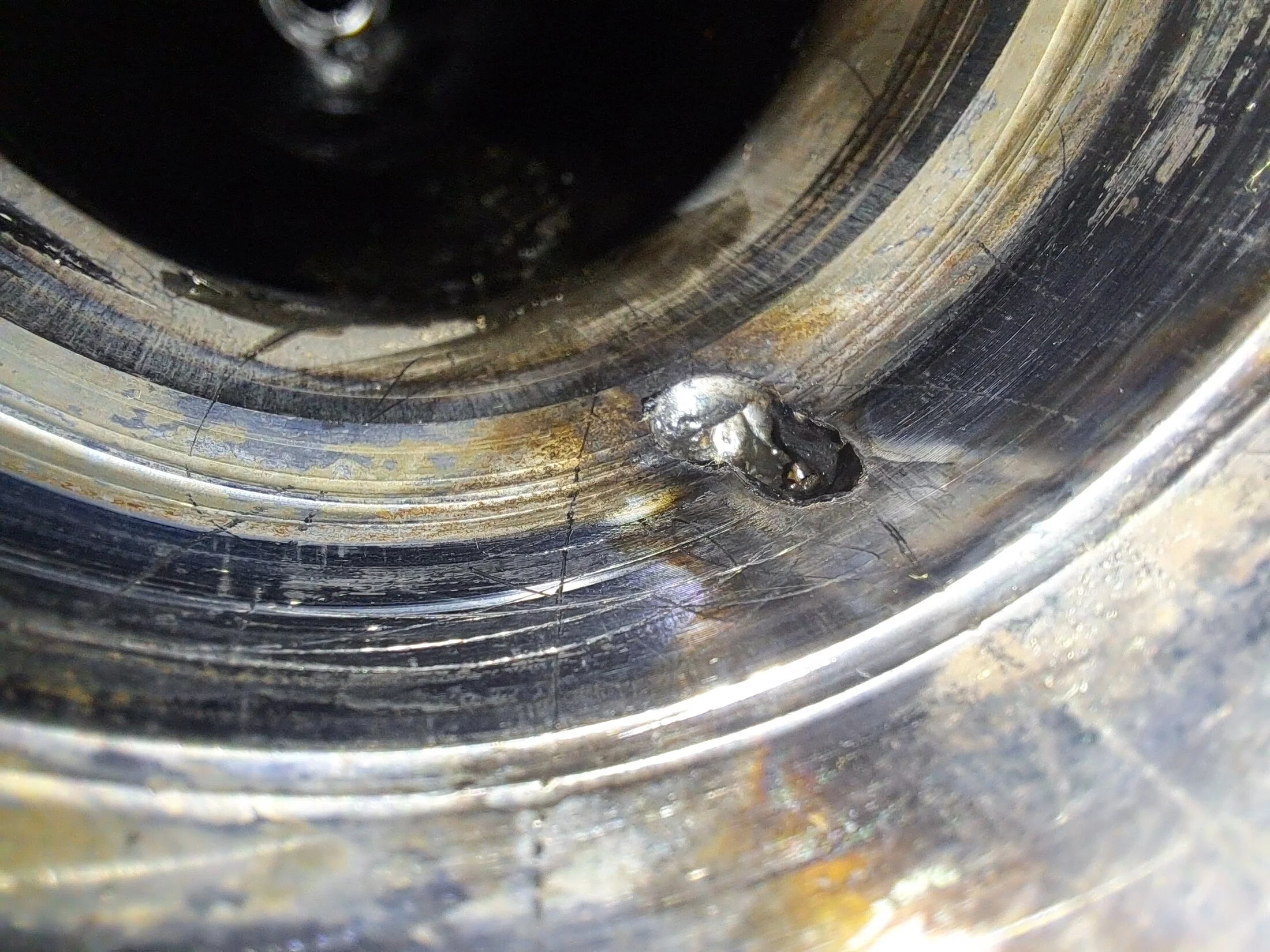

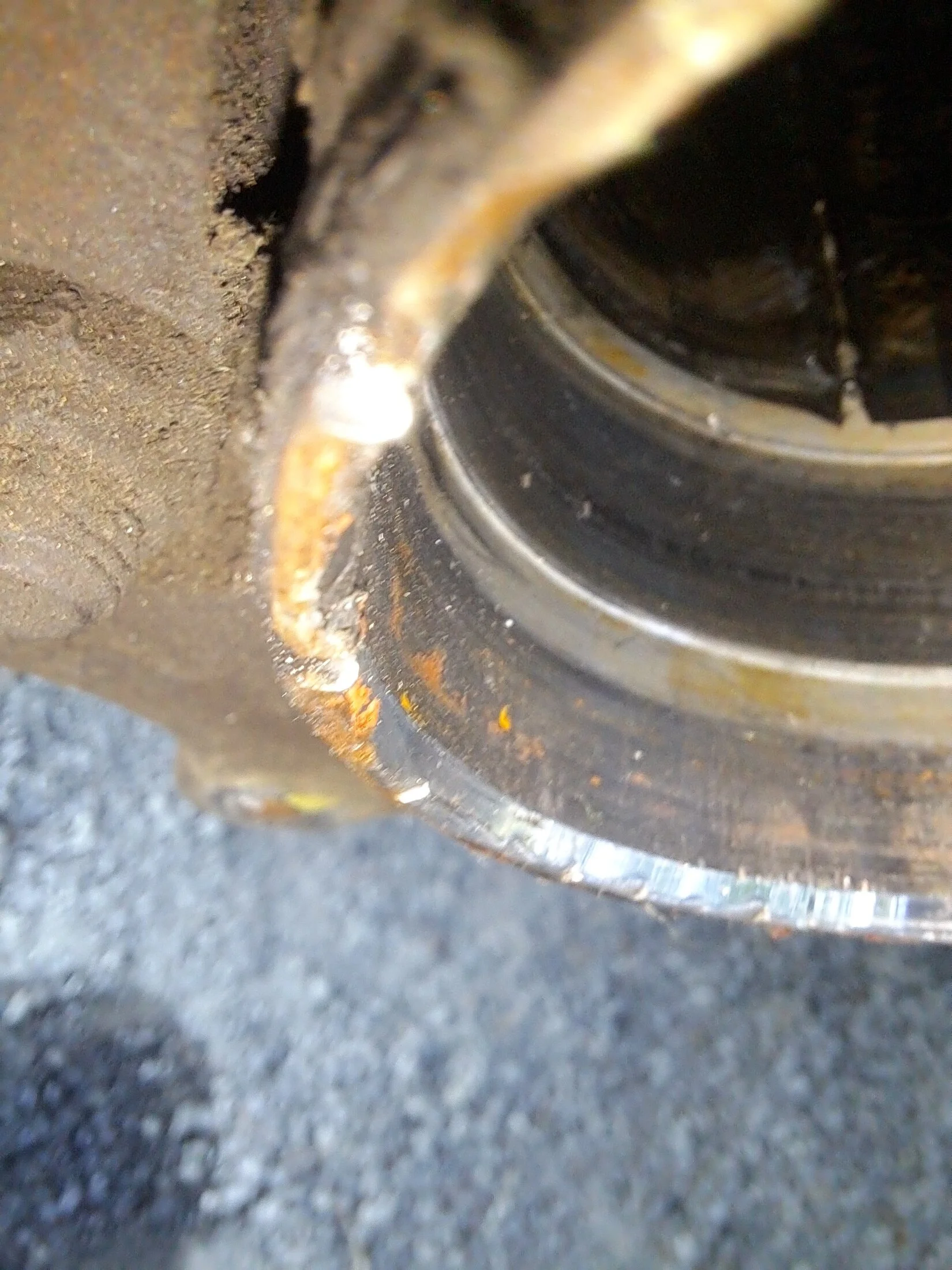

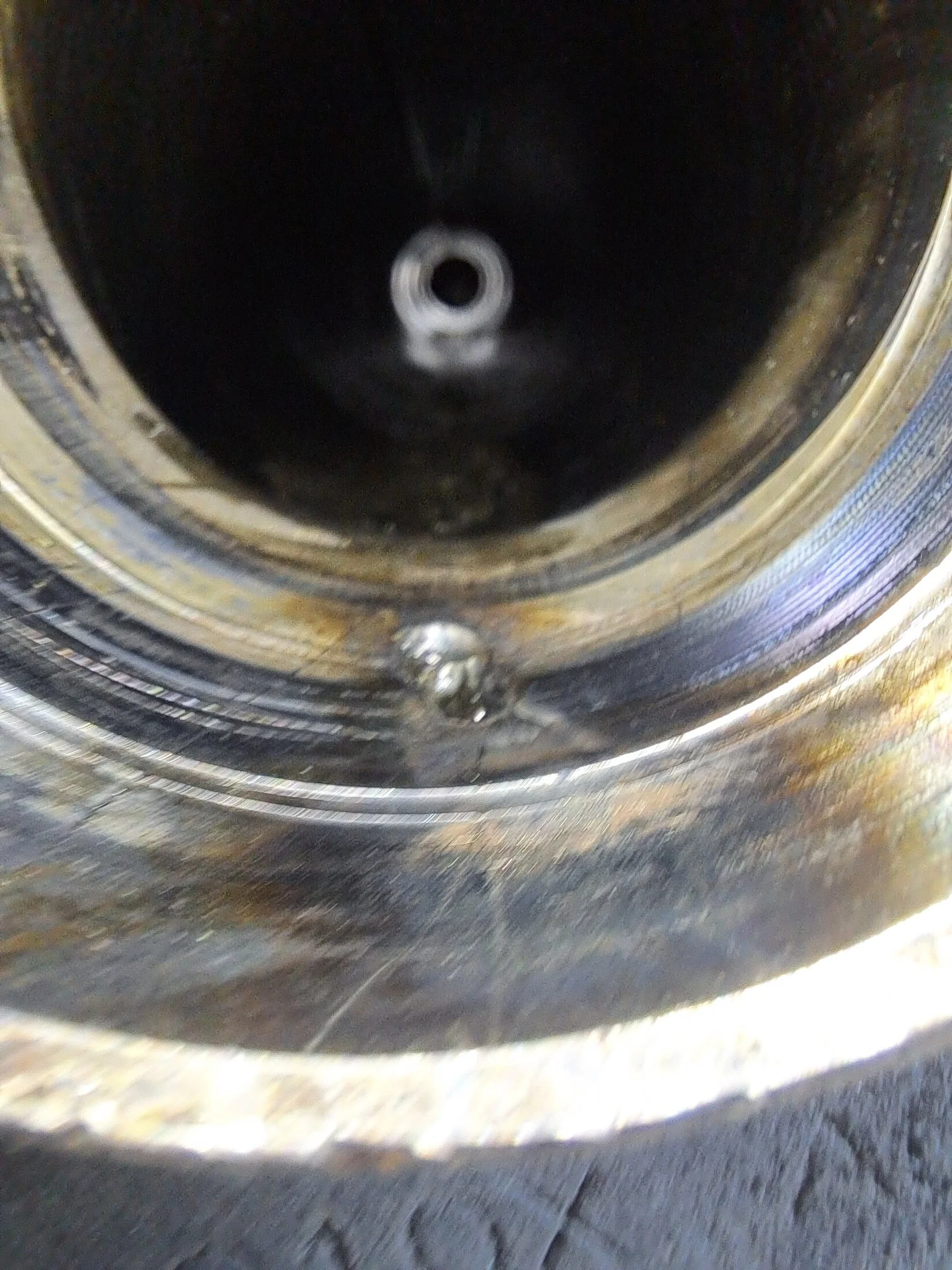

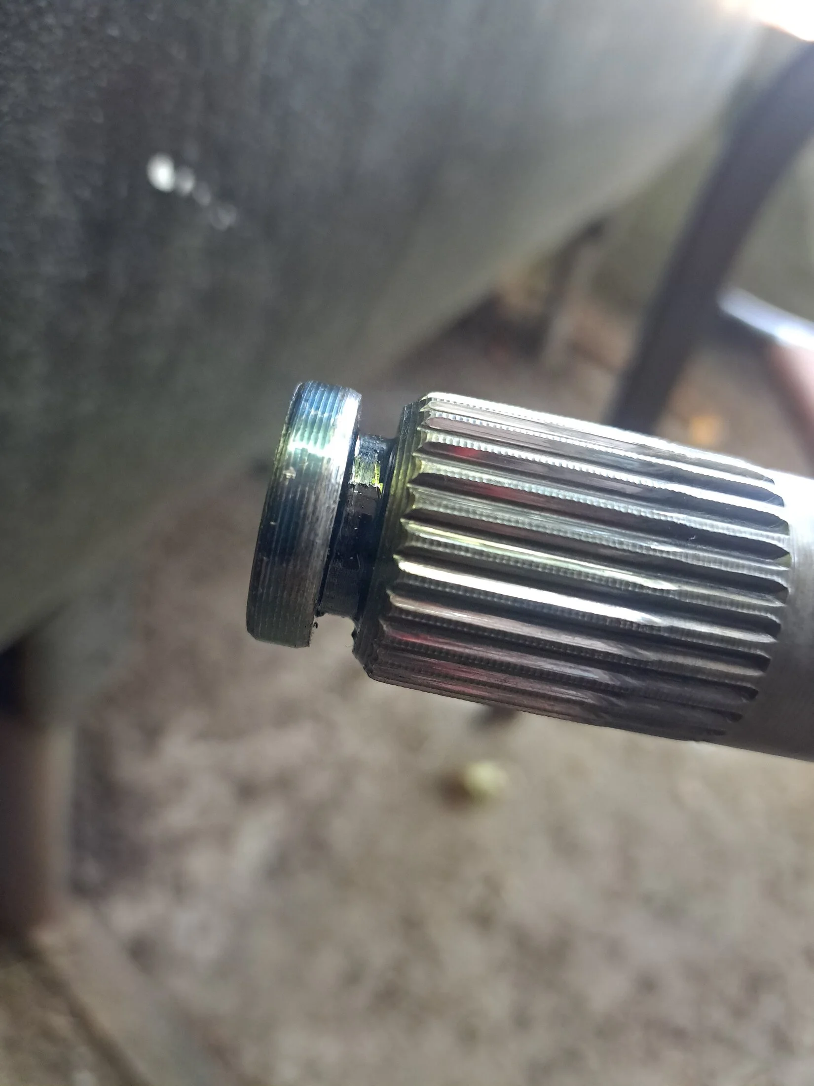

Finally had some time to actually get back into the repairs and upon closer inspection I've noticed the housing looks pretty... well.. pretty fu**** up. I'm not sure what to be looking for on the shafts as far as "that is damaged and indicates (insert problem here) is fubar" does anything look out of the norm? Bearings and seals were removed very tenderly with the proper gear so I'm 100000 % positive the scores and marring weren't from removal.
