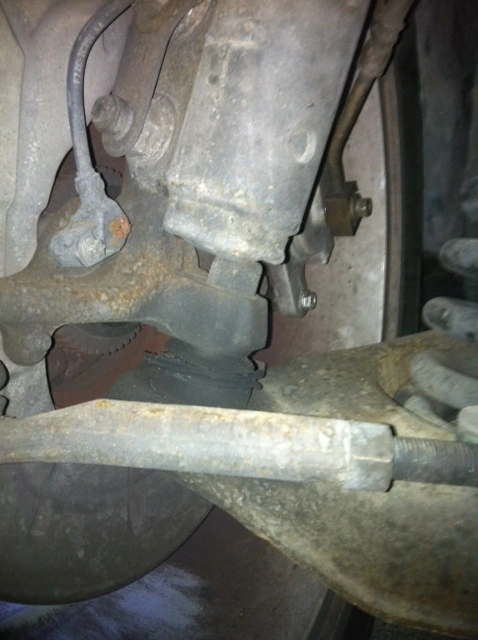

Could be a dry ball joint or Caster camber plate bearing
1) Try jacking up the front end with both front tires off the ground.
2) Get under the car with a pry bar of some sort and check for movement between the Spindle and A-arm. making sure not to damage the grease boot, there should be no up/down slack there.
3) Inspect ball joint grease boot for damage/cracks/leaking grease.
4) Have buddy turn wheel left/right while your under car to narrow/verify results.
It could be the joint just recently ran out of grease, then the up/down slack would not be as pronounced, but will get worse over time.
If you have after market CC plates the bearing should be accessable from engine bay for inspection.
Hope this helps.

whats it look like to you? it look like it needs to be replaced to me.....
jjFORDmustangGT
Apr 21, 2011
Tampa FL
Apr 23, 2011
  • Apr 23, 2011
Yep, grease boot is toast:-(
Not sure of your money situation, but you probably could find a good used A-arm cheap from someone doing a k-member swap.

The whole a arm needs replacing? Not just the ball joint?
no, was just throwing out an option to help keep costs down.
I am not sure what year car we are talking about here.
On my 04 this would involve the whole a-arm being removed to have the new ball joint pressed in, and then getting the front end alingment redone.
There may be cheaper/easier options, but in reality I just bought new 03/04 cobra A-arms got the alignment done and was done/happy with it.
