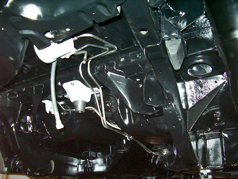

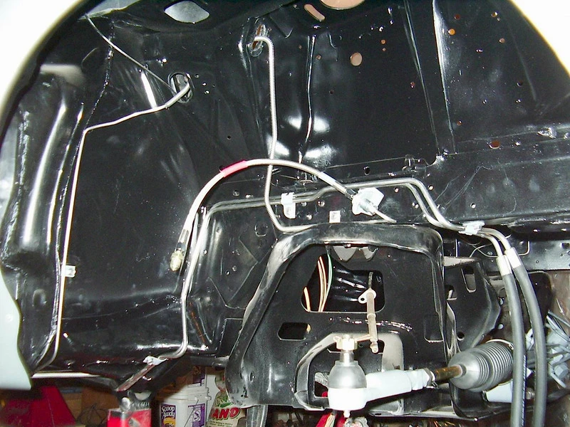

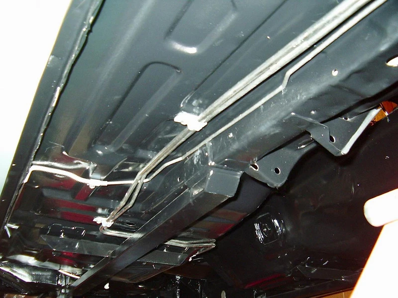

Bought new pre-bent fuel lines from late model resto because the guy I bought my shell from had removed them from the tank to engine. Ive searched online and 4 junk yards for an idea of how to run these things with no luck. I have an idea of how they are run but not completely and its driving me nuts. Im pretty sure I have it from the tank over the rear, down the transmission tunnel then it cuts to the right (if your at the back looking towards the motor) and up along the subframe but once it gets to the k-member Im lost. Before I great frustrated and go bending stuff and "making" it work I figured if Id ask if you guys had any ideas. Pics or advice would be great!! Thanks.

Ask and Ye shall receive...
Starting at the filter:
After it makes the turn from the hump and runs under the subframe:
And at the front it goes up into the fender well and along side the frame rail till it turns and runs up behind the alternator:

capri debris - wow thanks thats a HUGE help!
