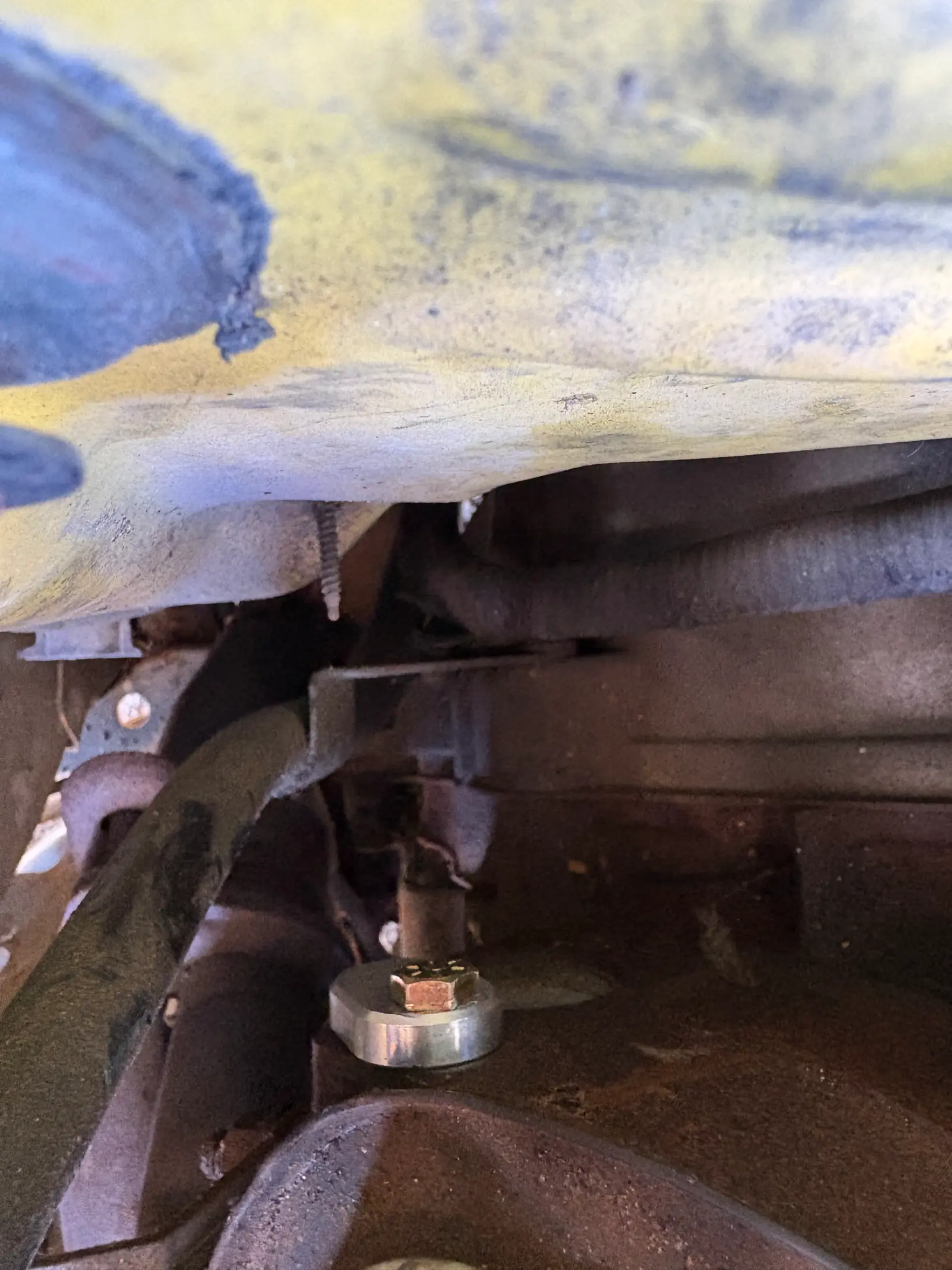

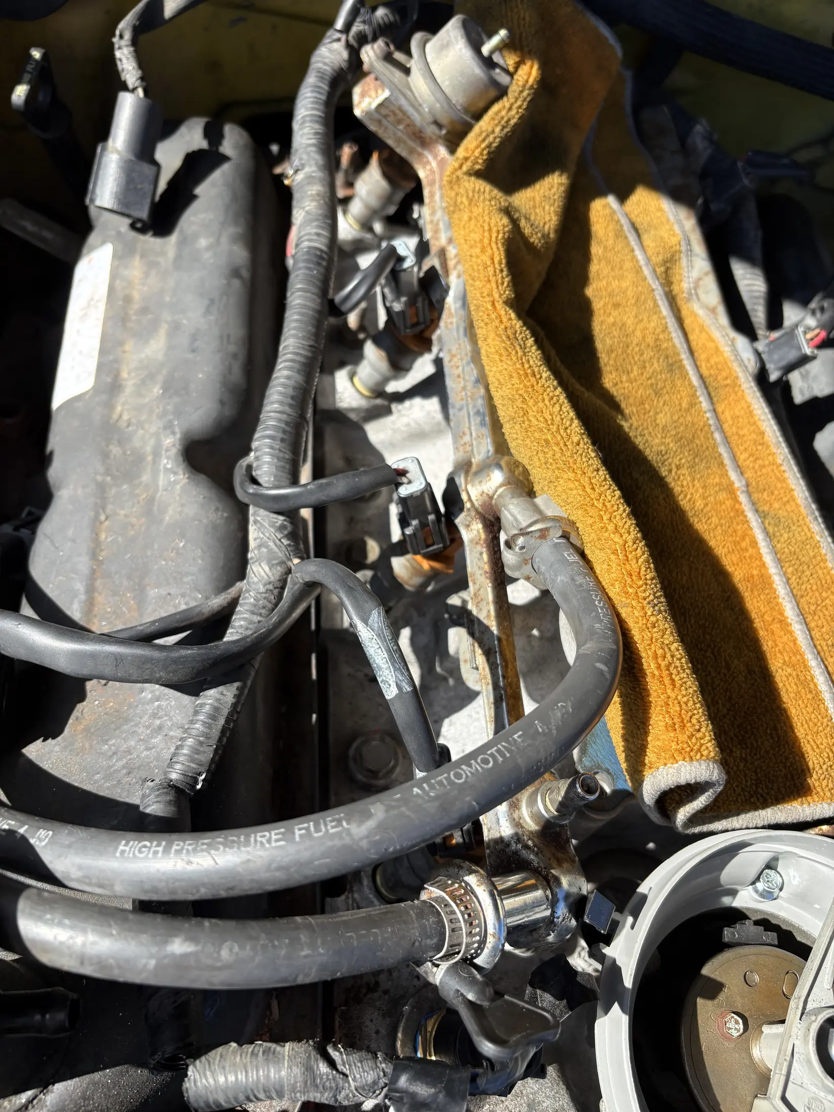

Hello fishnchips here new to the threads bought a 95 vert 5.0 as a project had a bad manifold from the previous owner snapping the thermostat bolts in the manifold I swapped it out for a new manifold and I’m getting crank but no start got it to idle at least once but it was very sloppy idle, I do want to add that I deleted the egr stuff on the car and the heat so the water pump line that goes to the coolant pipe on the intake manifold is no longer there other than not having spark or fuel pressure what can it be after having timed the car proper tdc ?

I’m honestly certain this manifold may be from an older model as well.
There a few open houses would that really stop this thing from starting? bc it wants to go and I got it to idle at least once but it was very rough and it shut right off.
You need to plug all hoses.
The #1 piston is a top dead center on both the compression and exhaust stroke so you need to make sure you are on the compression stroke when you line up the rotor with the plug wire or you could be out by 180 degrees.
You can only match the firing order to the year if you know the engine has the cam it was designed for.
You problem is likely a vacuum leak caused by a open hose or connector a hose belongs on.
When you deleted the EGR, did you plug the hole in the intake manifold which the EGR goes to?
You replaced the whole lower and upper intake? How did you seal the China walls? Vacuum leaks can happen not just from hoses.
I bought the gasket kit from the auto part store and a ton of gasket sealer I guess. I did manage to get it to idle now I’m reading though that it should be set to ten degrees as the HB is that correct? unless tuned otherwise ?
Basically I had the small sensor plugged in at the time which was not helping I did get a plug kit to seal all the air hoses I was no longer going to use and it helped a ton I’m just going to buy a timing light and try to redo the entire timing process from scratch.
