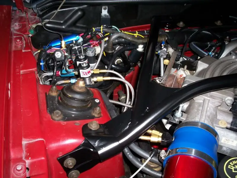

Mine runs under the car roughly following the same path as the fuel lines. My feed line comes into the engine compartment on the passenger side. I had just enough line to make it work.
bill302
Nov 2, 2005
2,131
46
alabama,gadsden
Jun 4, 2007
  • Jun 4, 2007
same here just followed the fuel lines...up into the filter (blue filter behind solenoids) then into solenoid ect... you can see in the picture below...
