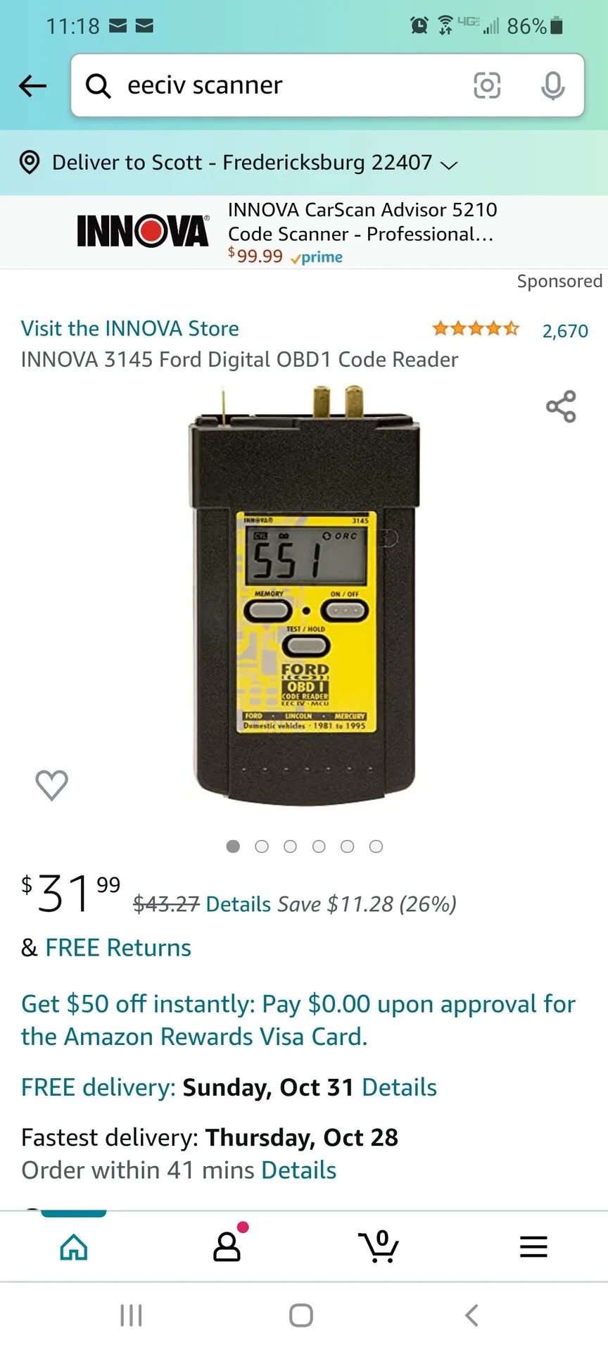

Grab yourself a Ford EECiv scanner. It plugs in behind the drivers strut tower and will flash or read codes. This will help to point you in a direction.
These codes will greatly help us help you.

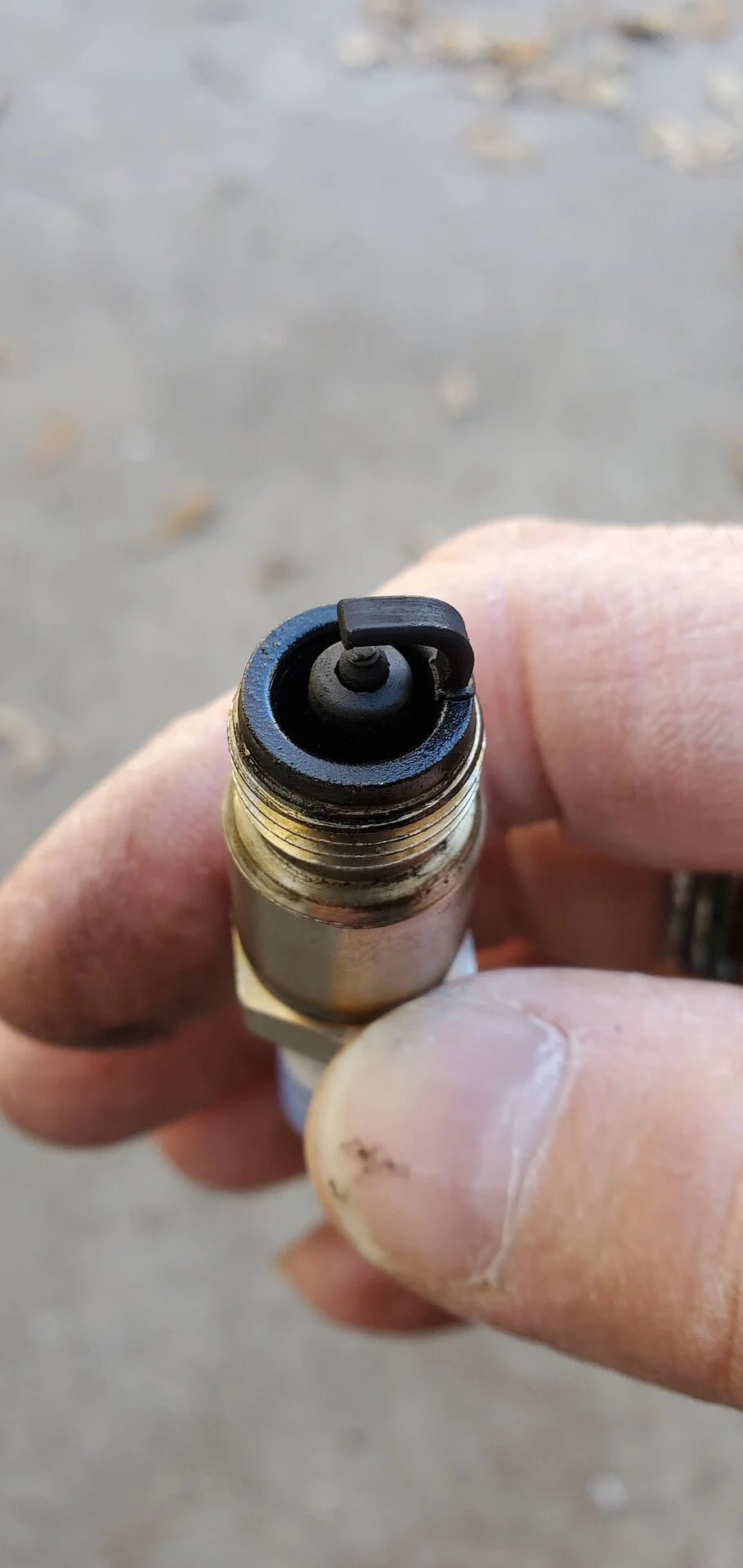

hello, I put the code reader on the car (I actually read the instructions!) and it doesn't do anything but display 000's. there is a square (not flashing) and a triangle on the display which the manual says means it's hooked up to the computer and if the square is flashing means its receiving codes. I put the fuel pressure gauge on it, when I turn the key on it goes up to 20 one time and 70 the next! I started the car and it settled down to 40 psi. it ran for a few minutes and sputtered and died. the fuel pressure dropped to zero in a few seconds. I pulled a plug out and here is what it looks like. usually when I turn the key on I can hear the fuel pump whine for a few seconds, now every once in a while it stays whining and reads 70 on the gauge. I was thinking of selling my car because I put 300 miles on it in the last 10 years but I don't want to sell a car with problems. I appreciate all the suggestions you all have made!
