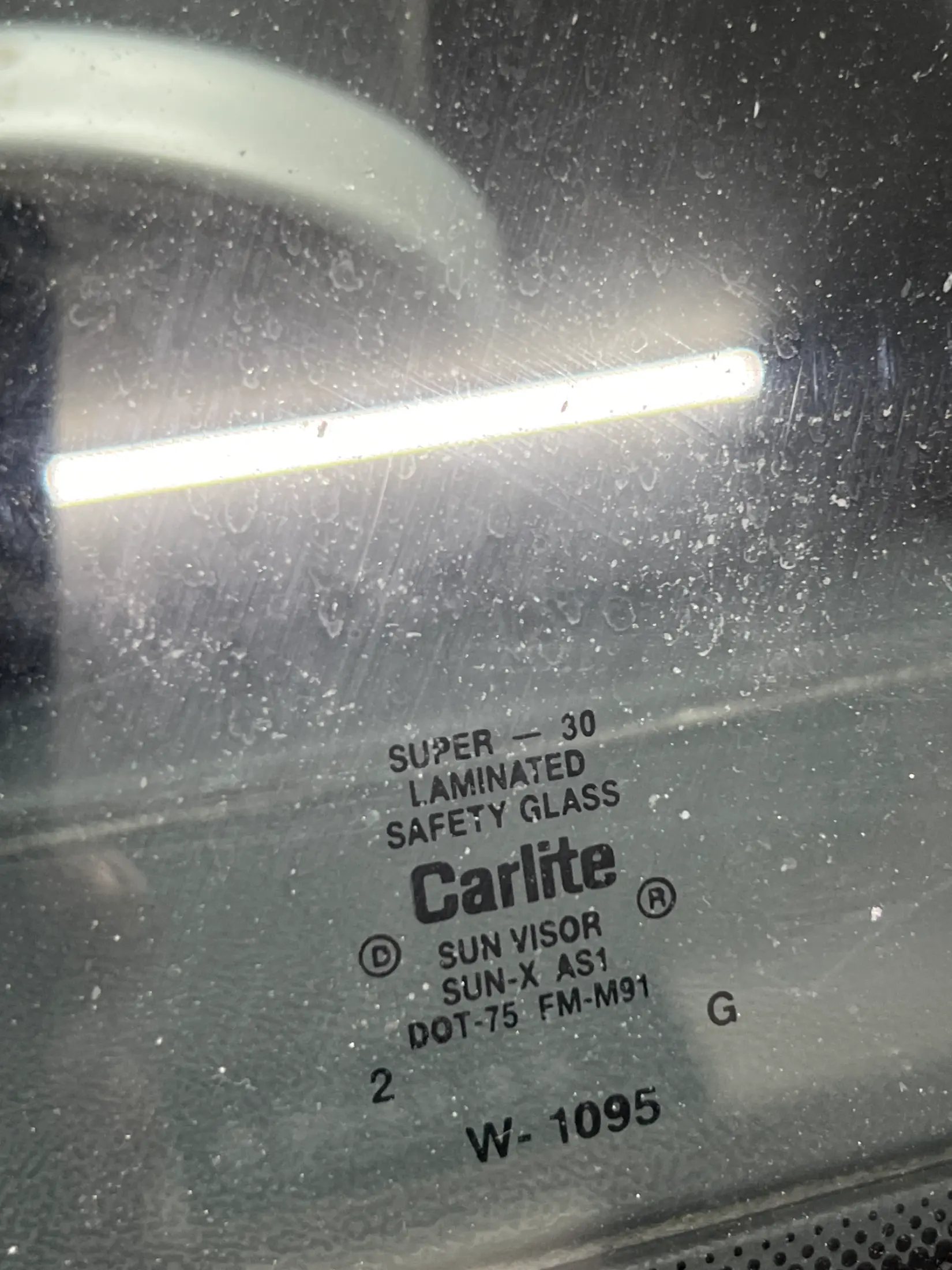

Can anyone confirm if my windshield is oem? From what I see online they’re supposed to have a ford logo on them? Mine does not…

Safelite did a great job replacing my assumed to be original carlite windshield 2 years ago with an aftermarket windshield that looks exactly the same with the black border and tint strip across the top,
I will be home at 7 pm and tell you what brand they used.
I hated losing the original glass but got over that real fast once I saw how nice and clean and factory it still looked. New glass is One of the best cosmetic improvements to any car IMO.
BTW: My carlite didn’t have the ford oval either.

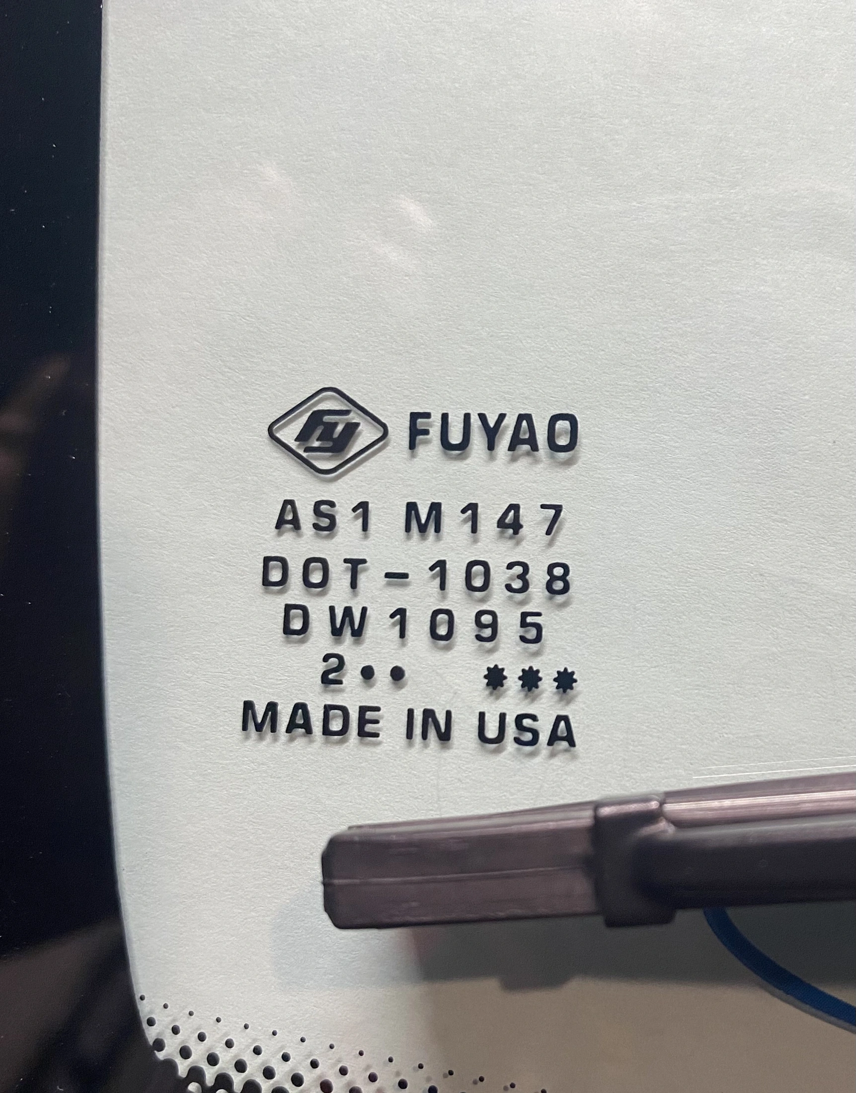

Although this is no longer needed but to answer your original question because I said I would:
The Safelite windshield brand is FUYAO [FY]… It is made in the USA as per the stamp etched in the glass.
They can likely get whatever brand you prefer but without me specifying what I wanted this is what I received.

I did a lot of glass work long ago, Carlite is a Ford company [or was] but the glass did not have the blue oval. Also note the difference, tinted means same level of color top to bottom just like the other glass. Shaded denotes the darker strip across the top and looks a lot better. Freight is probably so high because only 1/2 make it through ! There are still independent glass shops that may have access to Carlite parts. Just went and looked at mine again, sun-x means tinted glass, sun visor denotes the top dark strip.
Perfect that’s good to know. The glass I have now says sun visor and sun x, and the one npd has pictures also has those two so they should be a match
