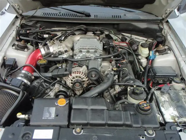

Here is a photo of it complete and an audio of the sound. Does anyone know what the sound is? I noticed stage3 had a head unit for $500 could i just buy that and slap it on? Or would it be cheaper to get it fixed? Does it sound like it needs a rebuild or what he described?

mat82284 said:
I just installed the saleen supercharger that i bought from this mechanic, and i hearing this terrible sound coming from it.
I'd take it back to him and show him what it is. He might be able to diagnose the problem....(or even better he might feel bad and fix it). He didn't exactly represent it accurately since it doesn't sound fixed to me!

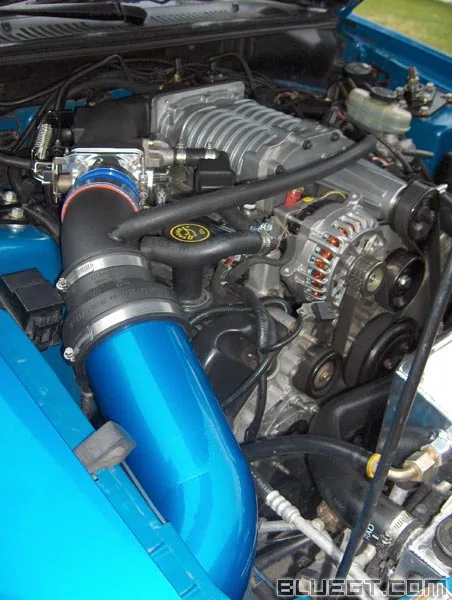

While looking at your car I realized that your supercharger looked different than mine. You actually have the series 1 supercharger and not the series 2 supercharger. Series 2 looks slightly different at the front and has a little more HP (only like 15 or so....). Here's a picture of the series 2. Notice the front area has no room for a saleen graphic and how the fins on the top are rounded. The series 2 didn't come out until 2001.
Thanks I talked to him and he said he try and get it fixed at the shop that supposably fixed it. As for the series I supercharger, I read online that if the blower has its own oil supply that its a series II and the series one worked with your stock oil. Is this true? If it is, could the series I been rebuilt into a series II?
