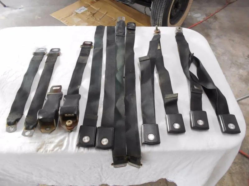

Ojay friends I have a 69 Mach 1 I am putting together and I have a box full of seat belts and not sure which one goes where. Does anyone have or can get me pictures of their factory seat belts front and rear so I know what is what please ? Thank you for your time in advance. Everyone on here has been very helpful to me while putting this put back together almost finished now.

Are they retractable? Can you post pics of what you have?

I can tonight. I do have 2 retractable pieces with just lap belt.

Pic of what I have

You're missing some pieces (male pieces for rear seats and shoulder belt pieces that mount on the roof).
The retractable pieces go for the front seats and mount to the rocker just behind the front seats. The two double belts (upper left and lower left in your pic) are for the front as well and mount to the hump just behind the front seats. They are double because one is used as a shoulder belt. The remaining two single belts are rear seats.
