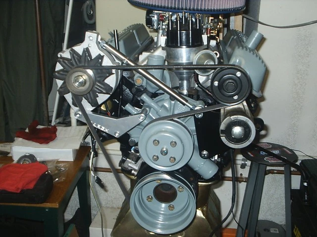

347Fastback said:
Here is my setup... It is a combination of stock mustang pulleys and march brackets...
This is how 12sec67 and I have our setup, except no tensioner. The belt runs up the pump and straight to the alt. Belts are cheaper too when they are only 40.1 in. :D

347Fastback said:
Hack
I have to agree with you and that is why I did the conversion. Very simple and straight forward swap...
I've owned an '89 GT and several late '80s and early '90s Ford V8 cars/pickups - as well as my Mustang and other assorted older stuff that used V belts. The serpentine is really a joy to work with compared to every V belt set up I've personally had to fix.
Your engine looks terrific. Thanks for the picture, I saved it for future reference - I need to rig up some brackets for my 351c I will be putting into my car next spring.
