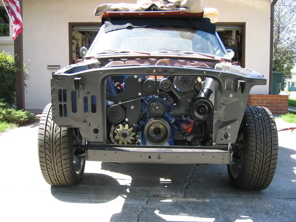

I'm running a Vortech, and a '90 Fox body serpentine.
If this is of help, I'd be happy to share more pictures, and info.
Notice how much of a "wall" this setup makes?
Takes a bit of consideration on how to get all the hot air out of the engine compartment, so as not to end up with cooling issues. Especially with A/C and the supercharger. :nice:
