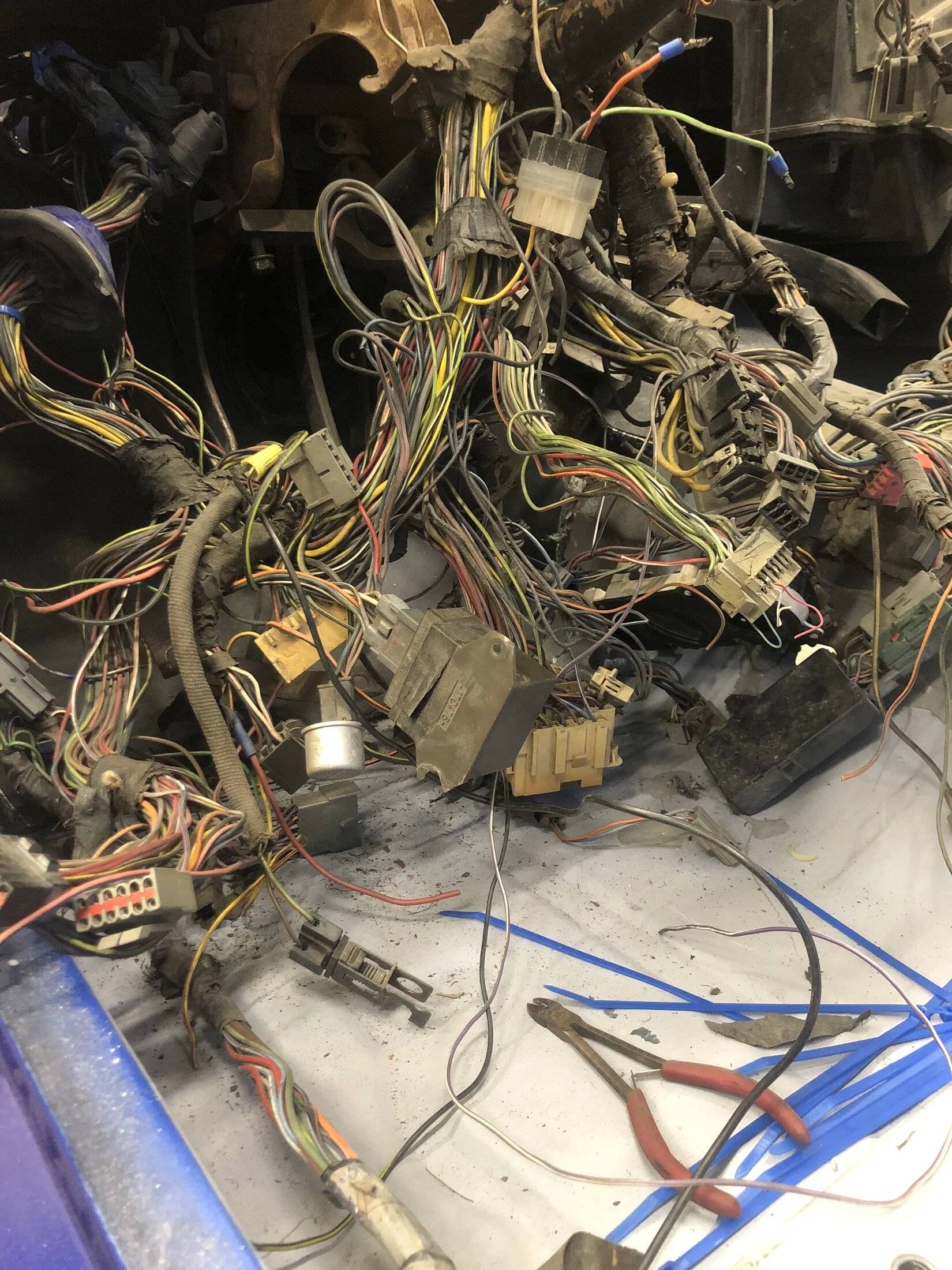

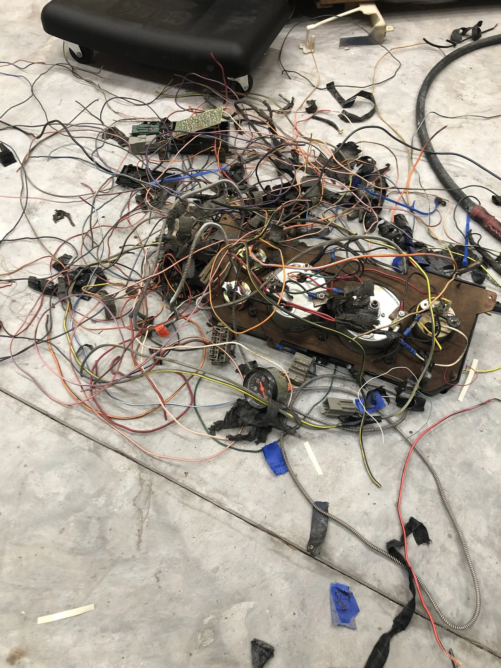

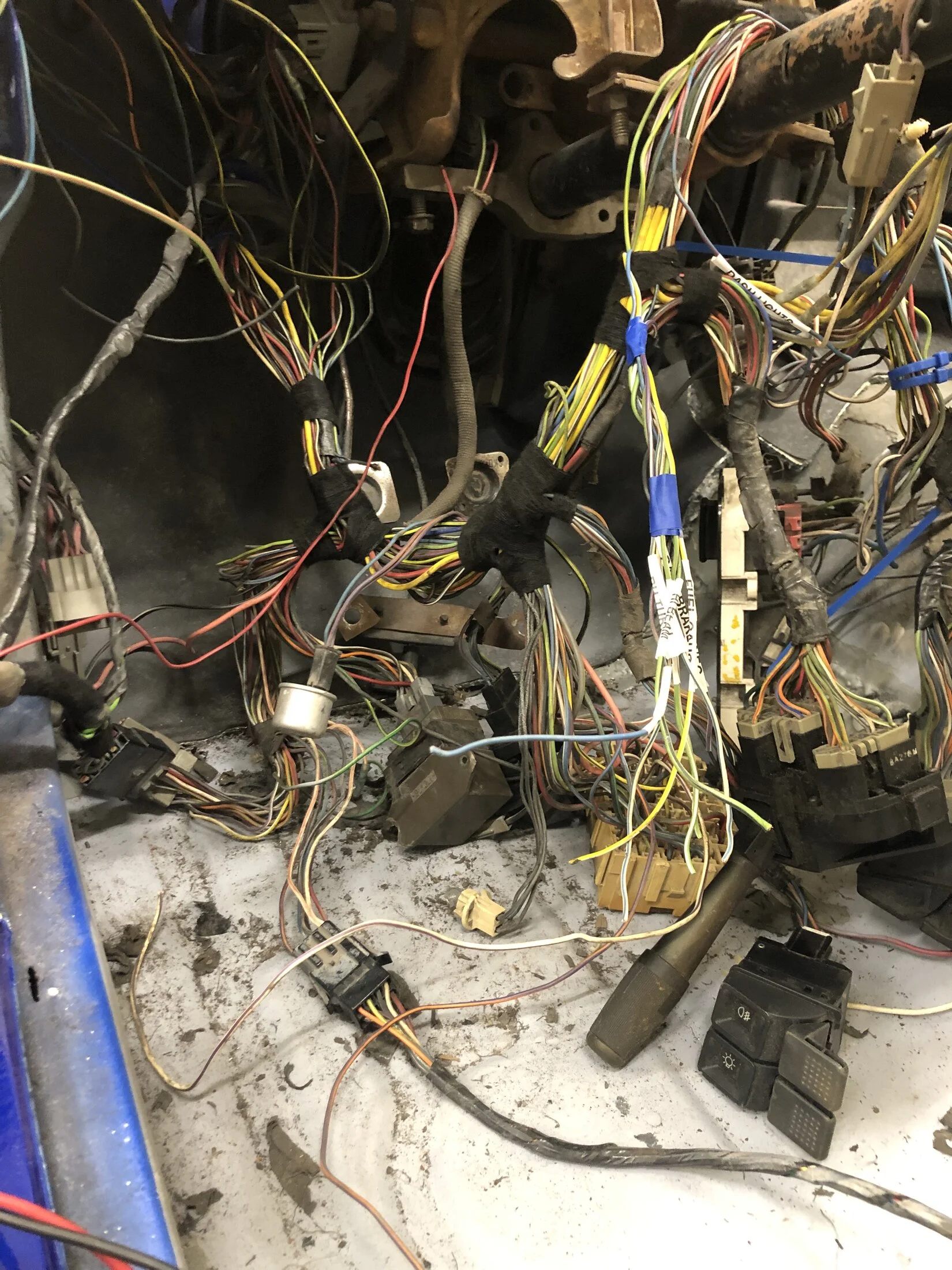

OK I think you guys talked me out of the shaved door handles, I was 50 50 on that one. Just had it stuck in my mind that if the battery died then what. I know there are other safe guards but I just kept thinking about the bad side.
As far as the push button still undecided. I dont have the dash in the car and I have pulled all the wires not used since the harness was a nightmare of cut and spliced wires from the guy who put the 87 dash in an 85. So I have aftermarket fuel injection, a dakota digital dash and a MSD box to install. My plan at this point is to get everything installed and make the car run, then I will worry about the push button.

Yuck

Blue85 said:
Yuck
OMG!! I almost tossed my cookies when I looked at those pics. to anybody that can make that stuff work, I just go cross eyed.

It’s pretty rough. Now they are sorted out. I will mount the aftermarket components where the original computer was in the kick panel. Once that’s done I will final tape everything and get it secured.
