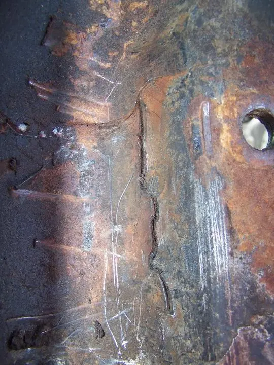

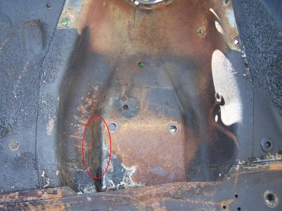

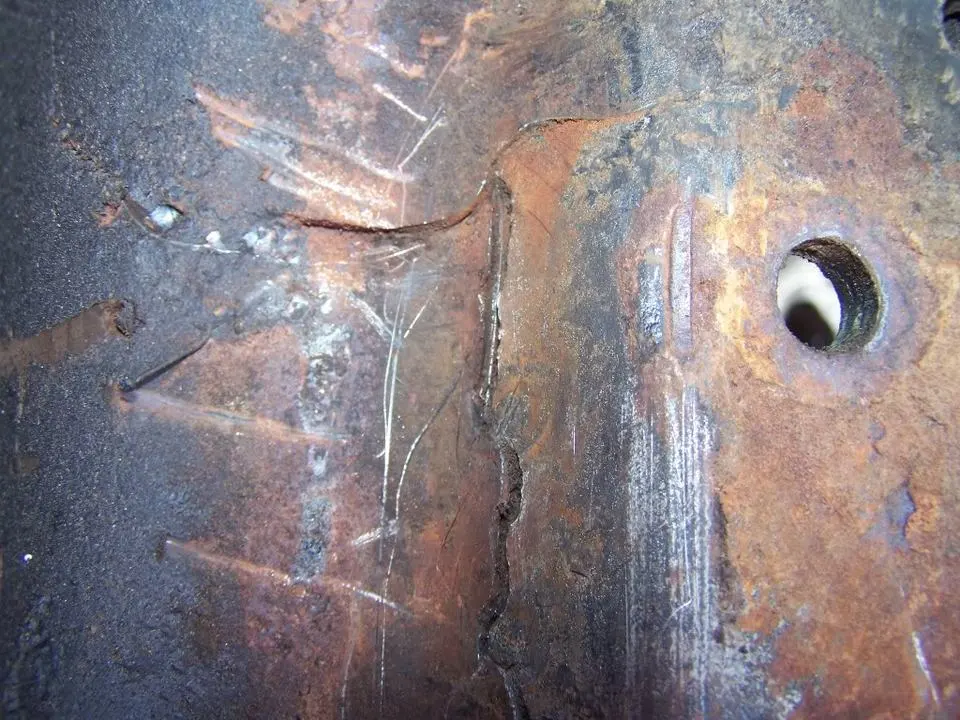

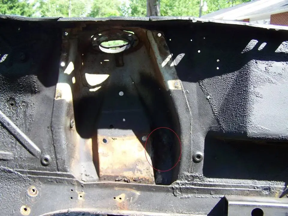

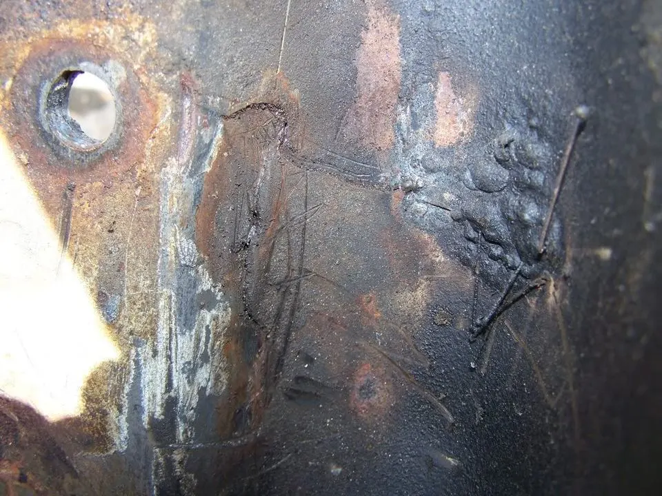

I was cleaning the stang today and as I cleaned the shock tower are I found this. It looks like it split to me. I looked at the passenger side and it is better but still odd. (notice the glob of weld on passenger side, could that be factory).
This can't be normal can it?
Or is this a case where I should replace the shock tower or weld it up.
See red circle:
Close up:
Passenger side
close up

That looks like damage to me. I doubt its factory. I agree that it does look weird though.

Doesn't look weird to me, I've seen it many, many times. The 67-70 towers are susceptible to this, especially when aftermarket wheels, with a positive offset, are used. Welding them will create a "heat effected zone" that will easily re-crack. The cure is new towers (for a long time only used ones were available). The prevention is to avoid wheels with other than stock offset.

I had a shock tower rip when I hit the brakes hard in an emergency. It held just enough for me to still be able to steer out of the situation, but it wasn't pleasant. I'd replace them now, if I were you.
Interesting. I considered rewelding them since they are reinforced on the other side and then adding the boss tower reinforcement kit.

Your right. Since I have it stripped anyway, I will probably be better off in the long run replacing them and then not having to worry about something happening down the road.

I'd still go along with CopyCat "over there" and 2+2GT "over here": Just grab some new shock towers, either from Don or any of the Mustang suppliers that sell Dynacorn products. That company sells the "big block" shock towers that are already reinforced for the heavier engines.
It's up to you; re-welding them with all the reinforcements, or replacing them with the reinforcements already robotic welded in......
I'll be buying new ones and welding them in right after I do the floors and TB.
