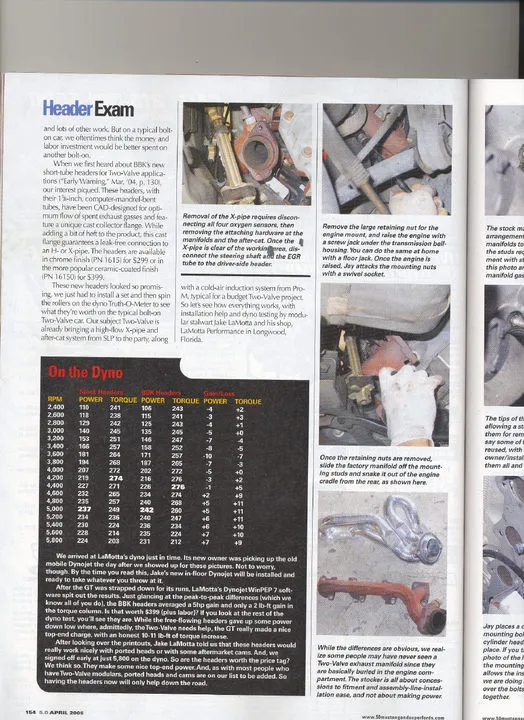

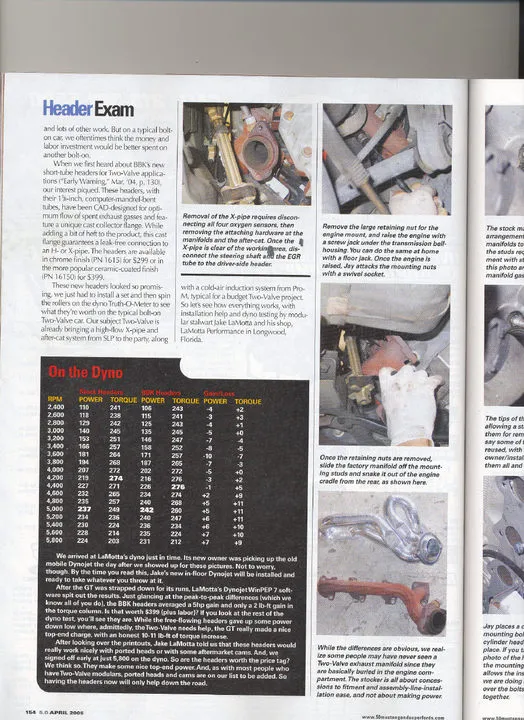

I just installed BBK Tuned Length Shorty Headers on my 03. Here's an article in 5.0 about the HP gains on a stock 4.6L 2V.
Go here for how to do the install.
http://www.stangfreak.com/content/index.php?option=com_content&task=view&id=52&Itemid=1
I will be doing a dyno on mine the end of this month and will let you know how mine came out. I did a baseline run last month just so I would know one way or the other if shorty's are worth it. IMO, it was worth doing the mod just for the challenge of doing it.
I'm so pissed that people keep posting that article. Those numbers are made up. AT A SPECIFIC RPM, IT IS IMPOSSIBLE TO LOSE TQ AND GAIN POWER OR VISA VERSA. Look at the relationship between tq and power if you dont understand. Their numbers are junk. Ignore them.
