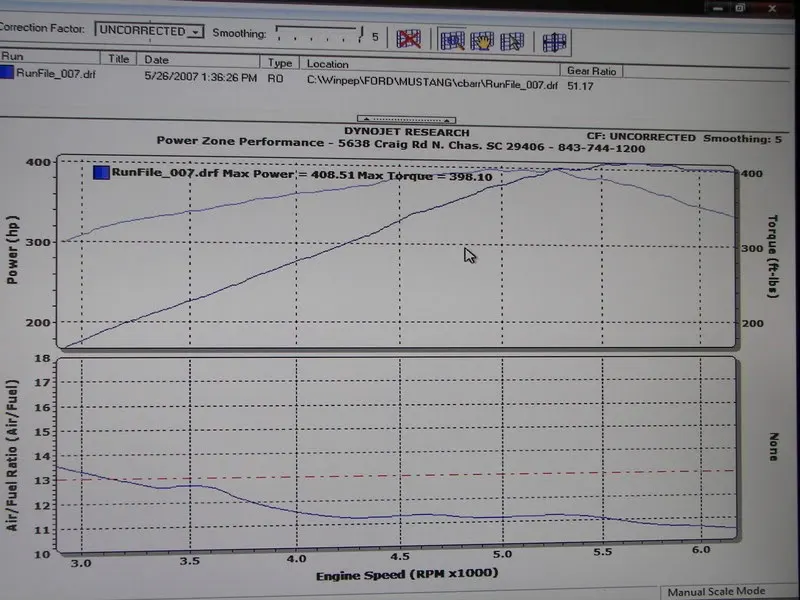

the more air you flow, the more difference it'll make.
and yup, been following that one for a while now, Grady. I've always seen the great low-end torque a lot of guys on this forum put out...and I also noticed that a majority had LTs...I wanted some low-end..so I got LTs, and I'm more than happy. My philosophy was....if I was to go and build a house for the first time...would I listen to the guy who is having the house built for him, or would I listen to the guy that's been doing this his whole life. Obviously I would ask the guy with the experience. The same holds true with modding cars.....I don't like going off of just word of mouth....actual proof is what it's all about.
I was talking to a few people the other day about the diff. in LT vs. shorty. One guy said that he gained horsepower with the shorties and he only lost a bit of torque....so he concluded the shorties were better. Welllll, I asked him if those were peak numbers...and of course he said, "Yeah." I'm trying to get him to get another dyno chart so I can compare and show him his before and after area under the curve.
Look at my curve...I'd be willing to bet my bottom dollar that if I put some shorties on there....my low end would look like poopy. Granted, my top end *may* look a bit better......I don't think the top-end gain would equal out the low-end loss.
