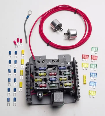

Your going to have to start with something. The Painless products seem pretty good: http://store.summitracing.com/partdetail.asp?autofilter=1&part=PRF%2D50101&N=310928+115&autoview=sku
For $129
I spent a lot of time planning and even included a few spare wires for future expansion, but it's hard to incorporate what the future needs will be.
I'm currently moving the battery and solenoid to the trunk too.
Do yourself a favor and get a kit with everything already terminated at the fuse block. You will spend more money buying wire than if you just get the kit that incldes the wire. Plus it (should) already be wired correctly and just require youto run each wire to each component.
I used painless but I think there are some cheaper brands out there that will do the job. Find one that has the right number of circuits you need and wont leave you with a bunch of extra wire or adding your own in0line fuse links...those always look tacky.
painless, ezwire, autowire, ron francis(the man who started the kit wiring), and others all have fuse blocks that are prewired, which i also recommend. you can get everything from the bare fuse block to a complete kit designed just for your car(even to the point of where you will put the fuse block if you desire) depending on who you go with. personally i like the painless and ezwire kits since the fuse blocks are prewired. but if you want the cadillac of wireing kits, ron francis is the way to go. he will build you a complete custom kit that pratically drops in. you have to do some work though, but not as much as with the other kits.
