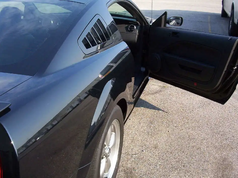

<a href="http://www.fquick.com/garages/viewgallery.php?action=viewimg&id=152554"><img src="http://www.fquick.com/images/vehicles/full/18208152554.jpg?1211894277" border="0"></a>
<a href="http://www.fquick.com/garages/viewgallery.php?action=viewimg&id=152555"><img src="http://www.fquick.com/images/vehicles/full/18208152555.jpg?1211894327" border="0"></a>
Now the fun begins...

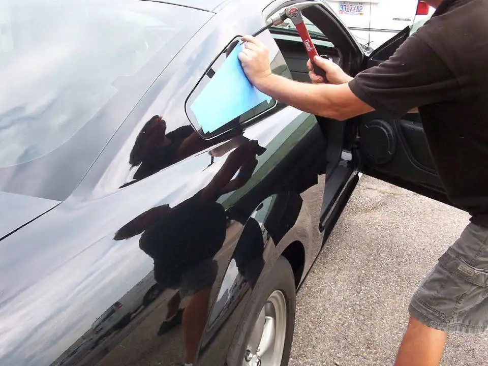

<a href="http://www.fquick.com/garages/viewgallery.php?action=viewimg&id=152556"><img src="http://www.fquick.com/images/vehicles/full/18208152556.jpg?1211894364" border="0"></a>
<a href="http://www.fquick.com/garages/viewgallery.php?action=viewimg&id=152557"><img src="http://www.fquick.com/images/vehicles/full/18208152557.jpg?1211894402" border="0"></a>
Almost finished!

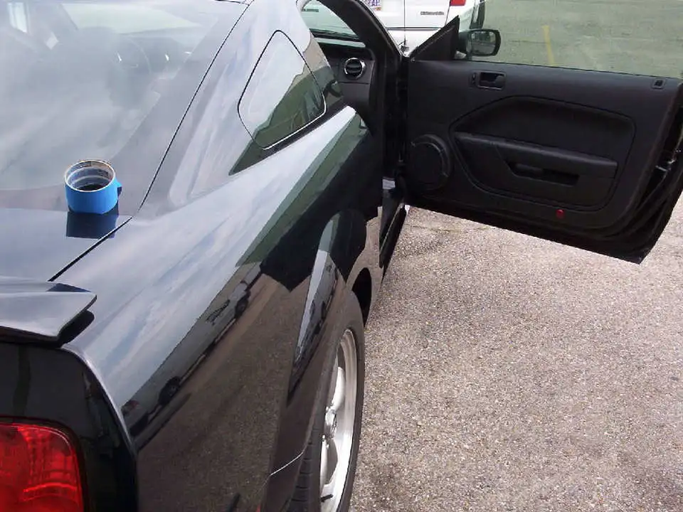

<a href="http://www.fquick.com/garages/viewgallery.php?action=viewimg&id=152559"><img src="http://www.fquick.com/images/vehicles/full/18208152559.jpg?1211894485" border="0"></a>
<a href="http://www.fquick.com/garages/viewgallery.php?action=viewimg&id=152560"><img src="http://www.fquick.com/images/vehicles/full/18208152560.jpg?1211894537" border="0"></a>
All done!

how hard was it to remove the factory windows ?
and how are the SHR windows attached?
69mach1-409
Apr 21, 2004
81
South Jersey
May 27, 2008
  • May 27, 2008
Thanks!
Using the wire cutting tool from SHR, the windows came out surprisingly easy.
They are attached using a 3M black adhesive applied with a caulking gun.
Did the install in my drive and it took maybe 2 1/2 hrs. Now I'm sure we could of done it ALOT faster if we weren't taking pics, drinking, and BS'n.
