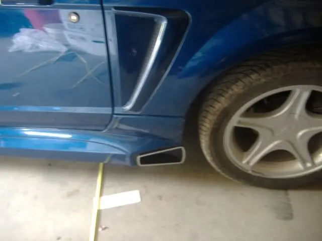

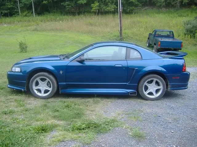

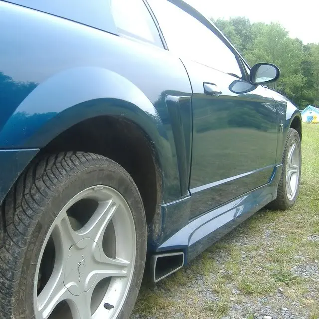

side exhaust done
and i got a V8 emblem to replace the GT :nice:

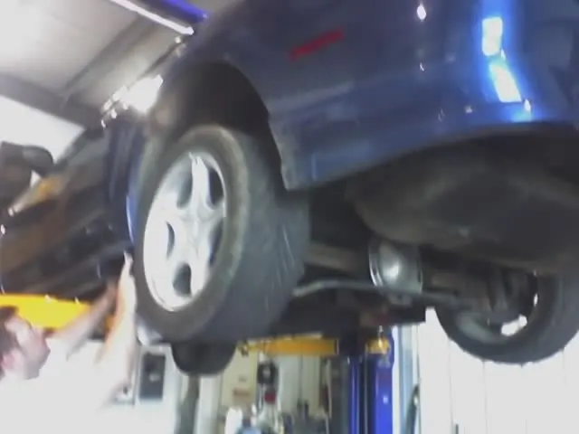

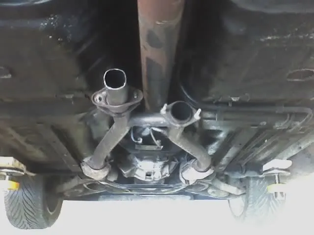

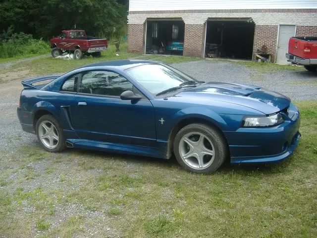

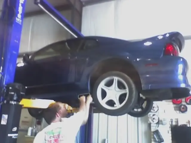

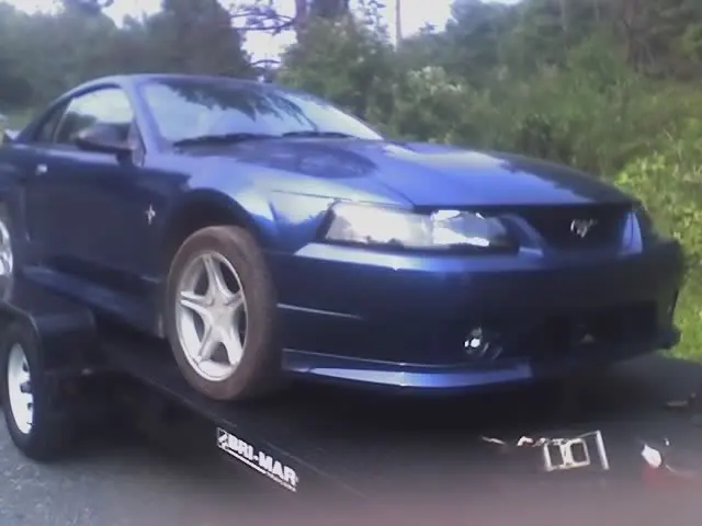

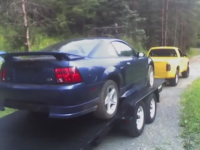

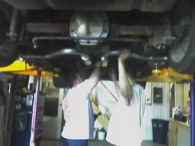

heres the car on the trailer and up on the lift and getting the pipes bent and welded taken with a crappy cell phone camera haha
^^if anyone knows him thats troy, (yeahloh95 on here)

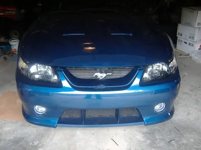

and finally a better shot of my homemade grille delete haha

I've heard that you loose some power with those types of exhaust, I don't suppose you dynoed after you installed it? I've been curious for a while.
only if youre using the side style mufflers (like spintechs the magnaflows that come with the roush setups) where the inlet and outlet are on the same side of the muffler. seeing that hes using a straight through design, he will likely have no difference in flow compared to a standard muffler. the comments about flow refer to the muffler design, not the piping.
besides, any loss is so minimal its not even worth bringing up. i run the spintech 333scs mufflers for reference and never felt a difference other than sound. anything flows more than the stock muffler anyways.
