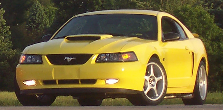

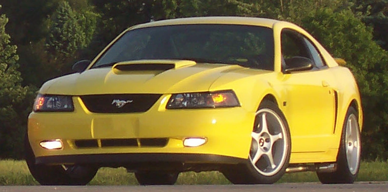

im always promoting my set up because honestly it's the best:p A 2" long connector pipe from the mid-pipe to a magnaflow barrel resonator then a gradual 90 degree bend out to the side w/ dual oval duoble wall tips. It's much less restrictive than the "back-and-forth" design of spintech and others. But, no, it is not quite
Not the best picture, but you get the idea. I will have more pic's soon if anyone cares to see!

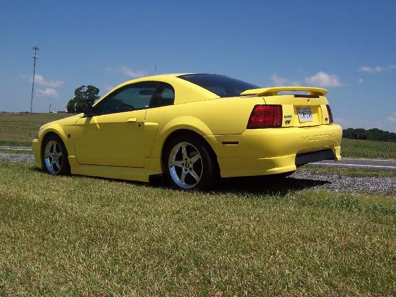

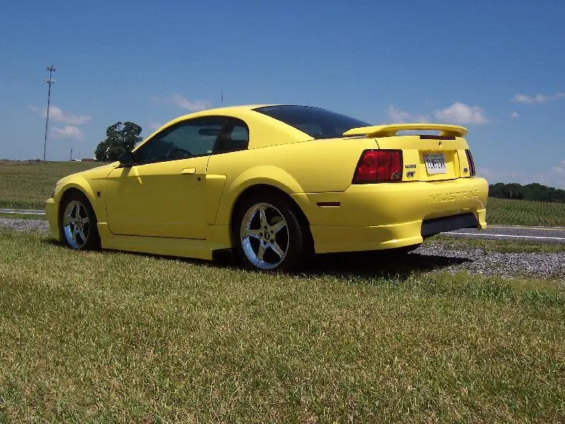

I do have one pipe going out each side, just dual tips - they're are both sides:
Yes, mine's custom fabricated, i baught the pipes and had them bent them welded them together. The advantages of this set up are being much cheaper (i paid about $350 all together), much better flow (spintech and roush have shown actuall losses in power), you dont have to pay for new side skirts to be painted, it doesnt sit too low (my cats from my mid-pipe hang much lower than the tips), and you can customize it to your liking - choose the tips and mufflers or resonators you like making it more quit than mine. On my future S-197 when i get outta college ima do the same thing.

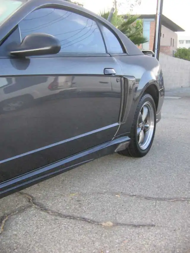

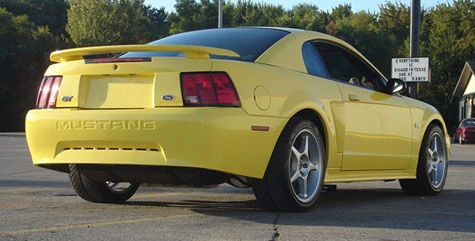

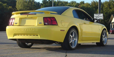

Here's my set-up. I just have a borla side exhaust kit(same as steedas) that where the mufflers are in the stock location so that the flow is back and then out the muffler forward to the tip. Steeda claims this kit was dyno proven to make 2rwhp more than their flowmaster catback. It is loud imo with my offroad x-pipe and is a little louder than the borla catback with the same offroad x-pipe. I also have a v6 rear bumper cover to get rid of the exhaust cut out holes.
Heres a guy with a roush kit. The v6 bumper cover might look plain on your car with the other exterior mods you have.

If I ran side exhaust, I would have to go to a v6 rear bumper.. All of the stick on exhaust cutout covers look cheasy..

yea the roush rear is much better then the v6 rear bumper...that is what i was going to go with if i did side exhaust. i think i am going to keep the rear i have now though.
