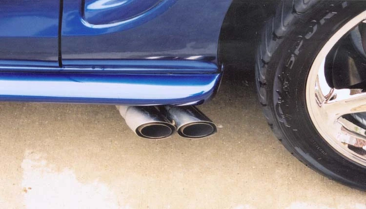

ive been looking at some side exhaust recently and remembered something about the borla kit having side skirts moulded around the tips and something to cover up the holes on the bumper, i was wondering if i remembered right and if so if the steeda kit has them as well
the borla kit does not have the skirts molded around the tips...just has a hole that has the tips coming through...I honestly didn't care for the look, and just put the tips on by themself, with no skirts.

Darkhorse845 said:
It looks simply beautifull! What stage Roush is that that is in the picture?
I like straight pipes but,to each his own.Good question does anyone have
any dyno sheets that prove side exhaust robs horsepower or low end torque?
looks like an older stage 1 or 2
