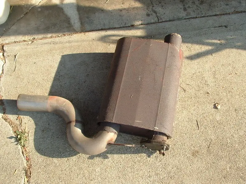

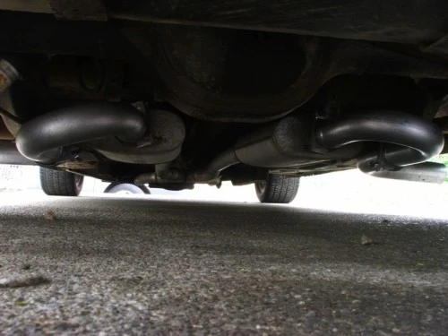

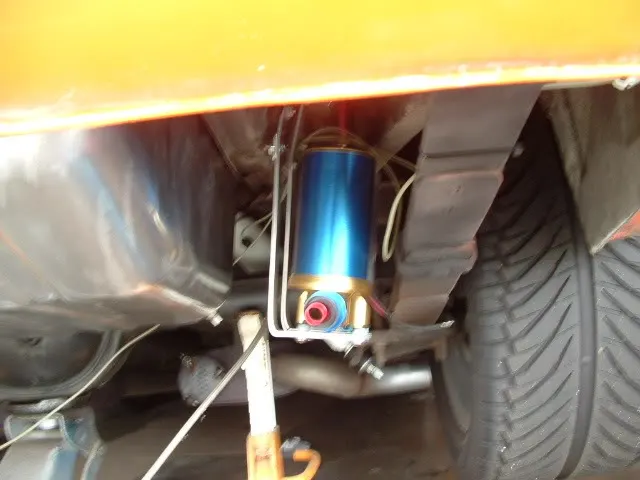

I might be selling my mufflers that have a mandrel bent exit in the near future once the turbo is on.you can barely see the pipe here.
I made my own for about $50 using Dynomax's "sidepipe installation kit" and a few clamps.
Yeah it's crooked but they're just clamped on and are easy to adjust. The outlets are even.
Other options are straight through DYnomax 'bullet' mufflers further forward and 90-degree pipes like someone else on here has, or Dynomax 'super turbo' mufflers that have the inlet and outlet on the same end.

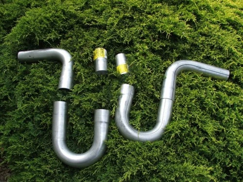

http://drgas.com/store/product.php?productid=3&cat=4&page=1 these will give you added clearence on your subs. or mabye this will work http://drgas.com/store/product.php?productid=18&cat=4&page=1 I still havent done this but I plan on using the dr gas frame clearence tubea and some magna flow mufflers http://cgi.ebay.com/ebaymotors/Magn...012QQitemZ220135341991QQrdZ1QQsspagenameZWDVW with a summit x pipe kit http://cgi.ebay.com/ebaymotors/Magn...012QQitemZ220135341991QQrdZ1QQsspagenameZWDVW I hope I can make it happen
I got mine off ebay for 150 bucks I just typed in nascar in automotive parts and all kinds of super bitchen parts came up. Dr gass sells them for 269 each thats with mufflers actually it is a muffler
http://drgas.com/store/files/master/product_images/new%20bt%20muffler%
or you can get this one for 209 each
these are not finished still need welding and coating.

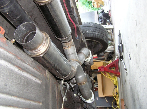

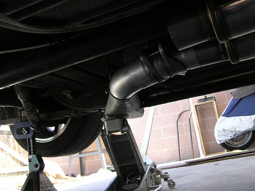

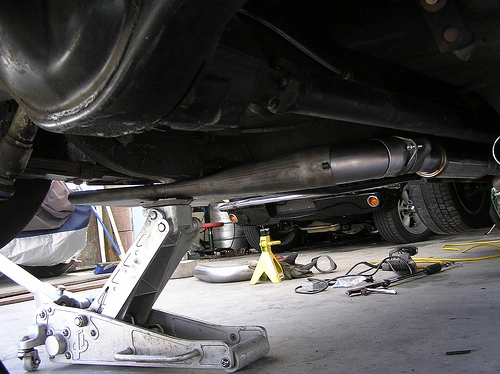

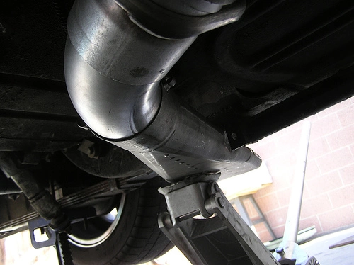

well i recieved the tubing I orderd from summit gawd I love them!!! Now I have the driver side mocked up looks like its gonna work. I had to notch the end of my tcp sub frame connectors and do some light massaging on the boom tube. I will have to add some kind of gusset later.
