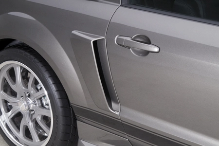

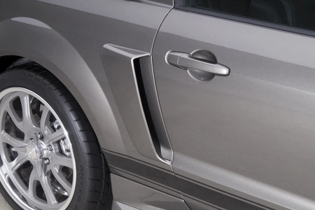

my favorite ones, they look factory to me, and they look like they fit the best, and flow with the lines the best. is the cervinis ones.
these are the ones on my car, i have those, and the quarter window scoops, and it made my car look that much more aggressive.

I have, but it was for trucks. Before my stang I only had lifted trucks. I figured two small pieces of plastic, would run way more than 20 dollars, but 150 dollars for such small pieces?
I could see maybe a top amount of 90 dollars but wow! I guess I was wrong.
by the way what size rims are running on? They look awesome, I have been thinking long and hard on how bis I want to go and yours looks really good.
I am leaning toward 18's right now for the cost reason and I don't think I will have to do alot of other mods to keep my HP.
