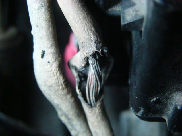

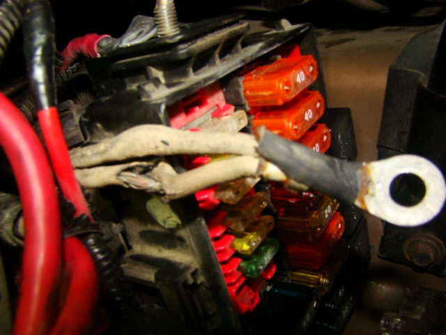

It is the fusible link that was smoking. Well it's the wires connected to the fusible link. Does this mean the link is blown? Here's a picture of the wire. It's burnt but not broken.

Ok so I took the new alternator back to Auto Zone. It tested good so no internal short. When I took it off, I noticed there were a few wires that were exposed just a little bit. So I taped those wires up to include the wires on the fusible link and tightened up the connector for the alternator's ground. Put the belt back on and connected the battery and everything was fine! Started the stang and no problems!
I'm thinking the main problem was the ground on the alternator. The connection was not as tight as it could have been. Now I have the battery on the charger so it can fully charge so that I don't burn up the alternator!
