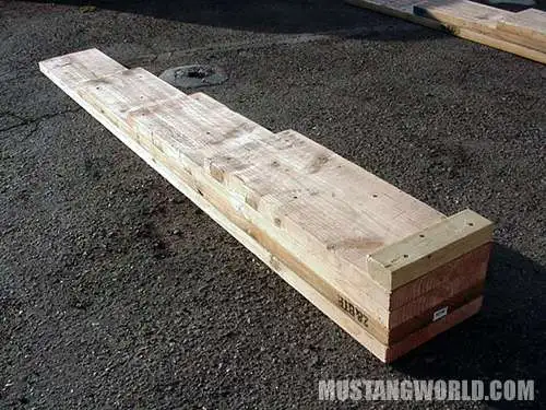

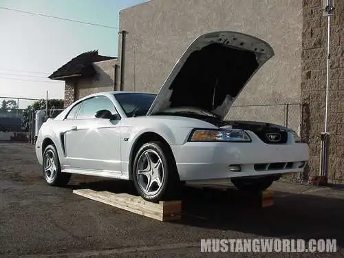

Basic overview:
Take 2"x10"s(or 2"x12"s if you have wider tires)and build step ramps with 18" between each step. As shown it will lift your car 6". Add a 5th row and your car will be lifted 7.5". Adding the 5th step will still not have your rear tires touch the ramp. Pre-drill holes for the nails/screws to prevent the wood from splitting.
That's what they were saying. Depending on the dampness of the wood, they could weigh around 30-40 lbs each. They said they used $30 in materials to build them. Not bad considering they will support many many tons and not scrape front ends that only have 2" of front ground clearance. Ground clearance is already a problem with the ramps I have and I still have OEM tires and suspension:nonono:
