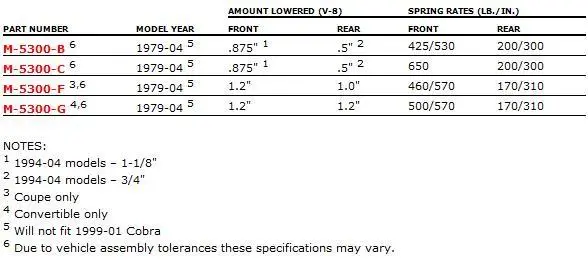

I've made my mind up to buy Ford Racing springs for my "86 GT vert.Either B springs or G's.Some places say the G's are for "79-"04 and some say "94-"04.I'd like to buy these today,so any advice would be great .Thanks

'79-'04 same beast. Don't know if the "G" spring is for you, here is chart on the Ford racing springs. Also if your going for a drop add caster/camber plates, a must if dropping her over 1" IMHO. Hope this helps.

Thanks for the chart,i ended up getting the B springs.Now to get some good struts.

guess I'm too late. I've got "C" springs on my '86 vert. Dead coil cut from the rears, and 1/2 coil cut from front. Drives like a tank on rails. Ran over a dime and felt it.
