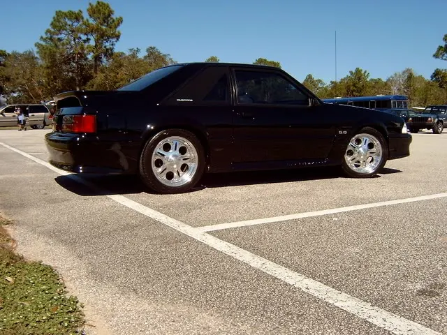

BC/CC
I decided I'm going with BC/CC.This picture made it for me...I borrow your picture for a sample Tim...Thanks....If someone knows of a darker depper look than jetblack please let me know I will be buying my paint soon.

That's it man. "99" Black is black as black can be. That was the color of all blacks for all cars. The car will be sick as can be bro. It will look great!! Remember...grey sealer before the paint and clear. Trust me, you don't want the paint to shrink after it's wetsanded and rubbed, so seal it up!!
