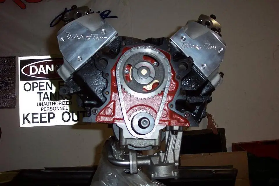

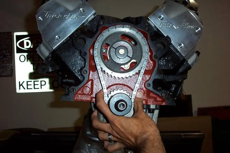

Did you buy the summit brand chain? The reason im asking is thats what i bought, and it had ALOT of slack in it. I think at most it was supposed to have 1/2" of deflection, and mine was right there.
I didnt want to start a new motor with a loose chain, so i bought the FRPP chain (45-50 bucks i think) and it fit perfectly.
I took a picture just in case anyone ever asked...
Here is the slack in the summit chain.
and...
how it should look..
I didnt get a picture with the FRPP piece on it because we slapped the timing cover on right after we installed it. but the frpp one looked tight like the bottom picture. In the instructions, it stated that you are supposed to turn the motor over, and that load will put a little tension on the chain, however, even with doing that, mine was loose as hell. I think if you have 1/2" of deflection right now, i would get another one. once your chain stretches even a little bit, it will be out of the maximum allowable limit

No problem man ! I believe that when you rotate the motor, one side of the chain is supposed to be tighter than the other. They tell ya in the instructions to do that (get the tension on 1 side) then measure the defelction on the loose side.

Right, but if he starts off with a chain that already has the maximum allowable amount of slack, IMO, he should replace that thing asap
