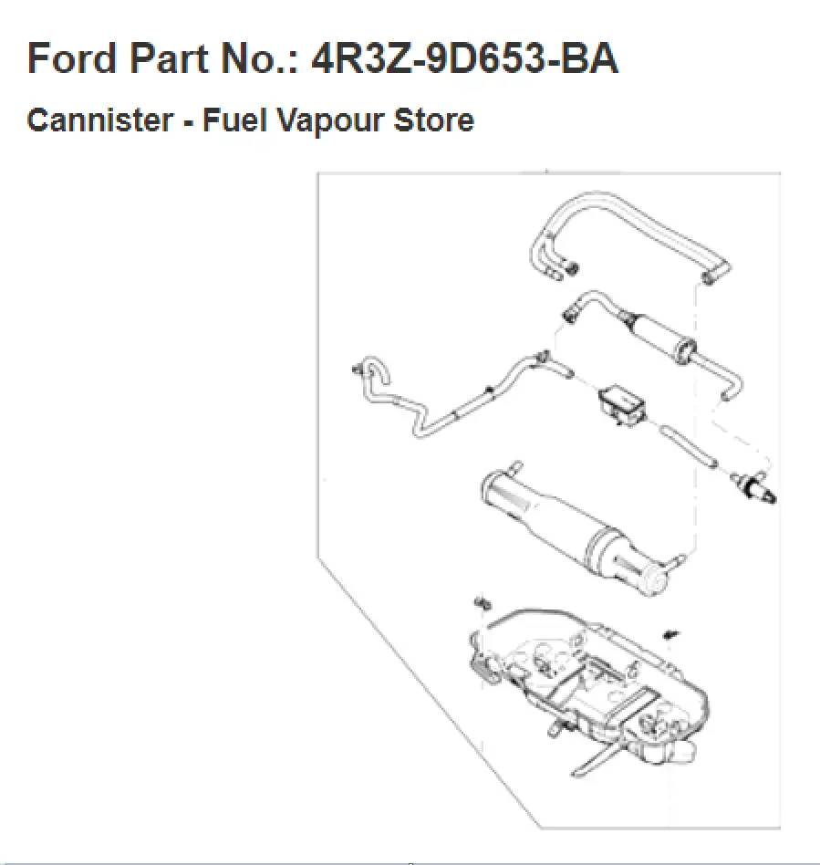

To answer your question tho... Nope, I don't think it will fit. I was just poking around for images of the one for 2005 and the think looks like a SCUBA tank integrated with the fuel tank.
You might want to start looking at salvage yards. Just get the whole tank. All I see is "discontinued" and "out of stock" for new ones.
Horrible image but this gives you an idea and I believe this is the correct part number for your aplication:
It looks like you're going to have to drop the tank, no matter what.
