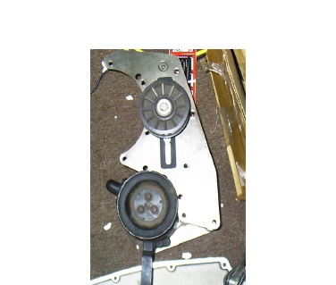

because with a sc you need the pump for the bracket wright

The SC bracket mounts to the smog pump??

mine does look

I would not have guessed that a blower bracket would mount to the casing of another accessory. Thanks for the visual shtty.

so what can you do to delete this nothing huh just buy a kit huh i dont think you can run a smaller belt

not without manufacturing another bracket to attach the blower bracket to it appears.
