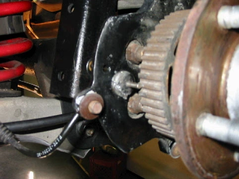

The ABS sensor doesn't come with the axle...it slides into a hole on the caliper/axle bracket....so that won't be an issue with Jesse's axle...Hopefully you can remove yours with out braking it....they suck to remove... :D Damn plastic...
This pic shows mine pretty spanked....but it still works...
Rio, he means the exciter ring. You can nget them from ford for around $15-20 or you can just get yours pressed off. If money doesn't allow for an upgrade to 31 spline, at least get a nice set of aftermarket 28 spline ones like superiors. I got mine from summit, they come with the studs AND new bearings for around $250. Assuming the posi is OK, you can just slip in the new axles and be done with it. There is NO reason why your axles snapped unless the forging was flawed from the factory. I have only seen one other guy break an axle on nittos, and it was in a new car. I think ford covered it under warrenty due to faulty forging.
