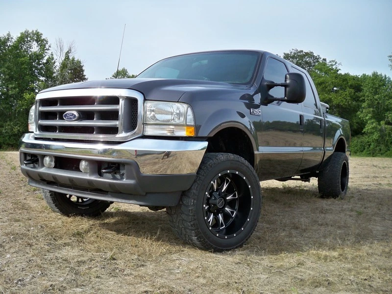

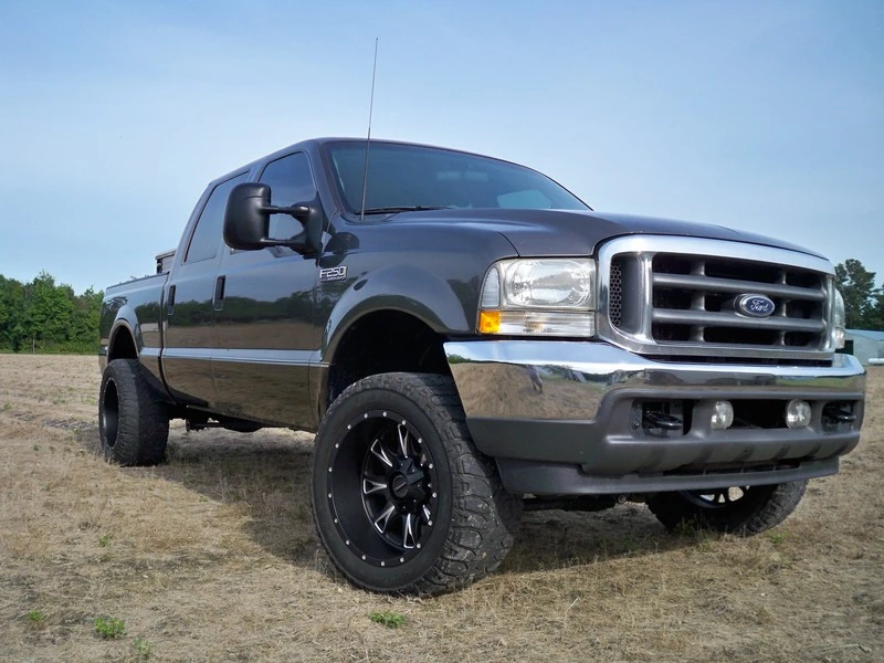

So, I got a Porter Cable and some M105/M205 a few months back. Wanting to learn as much as I could, I decided that I wanted to start on a vehicle that was really bad. My brother's 250k+ mile F-250 became the perfect candidate. While it doesn't have any dents, or more than a couple large scratches, the paint overall was hazing horribly and had swirls/water spots out the whazoo. He also removed the "4x4" sticker on the rear quarter, and the bumpers on the doors, which left outlines and a noticeable 'shadow' that he wanted removed.
The process:
Wash
-Meguiar's Deep Crystal Car Wash, double strength
Prep
-Full 50/50 IPA wipedown
Clay
-Meguiar's Clay Bar
Paint Correction
-Meguiar's M105 with Orange Pad; 3 passes
-Meguiar's M205 with White Pad; 1 pass
Paint Protection
-Meguiar's Gold Class Carnauba Wax
-Meguiar's NXT Tech Wax 2.0 as a sealant

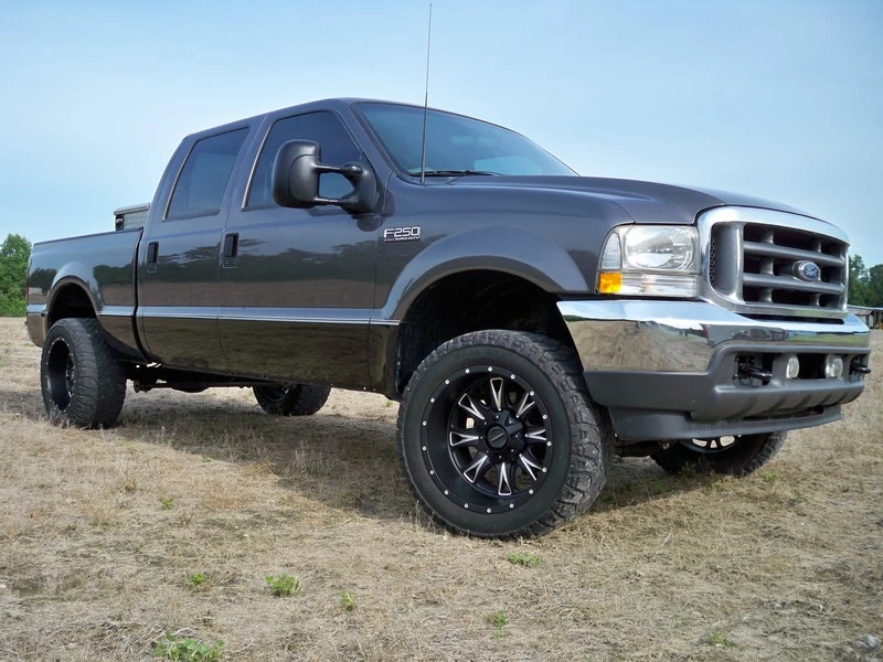

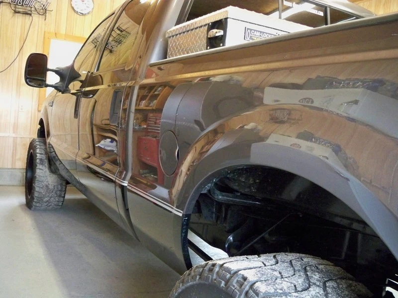

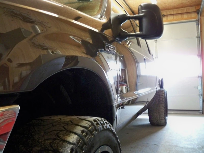

Unfortunately, I didn't take any pictures before I finished compounding. But as mentioned earlier, you can imagine how bad a 250k mile work truck that has sat outside its entire life would look....Anyways, here's a few after pictures with my crappy point-and-shoot and a video of him sled-pulling shortly after I detailed it.
Lemme know what you think.

Looks like the abs plastic on the lower front bumper needs some product on it. The paint looks pretty good though! Did you use a hand spotlight to examine the paint while using the PC?

I was just doing the paint. He was taking care of the tires, wheels, bumpers, glass, etc. Matter of fact, he got something on that plastic not long after I took these pictures, and I just didn't get chance to get any newer ones after that.

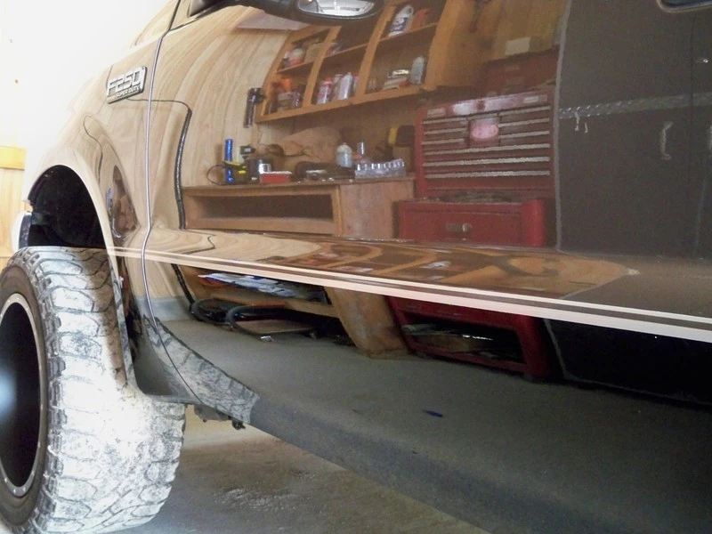

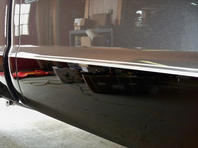

I was using one of those big halogen shop lights as I was going over it. You can definitely tell that there's no swirls in it if you look at it in person, but I just couldn't get my 7 year old point-and-shoot to capture a decent photo using one of the lights. It was quite ridiculous how much better it looked, even after just the M105.

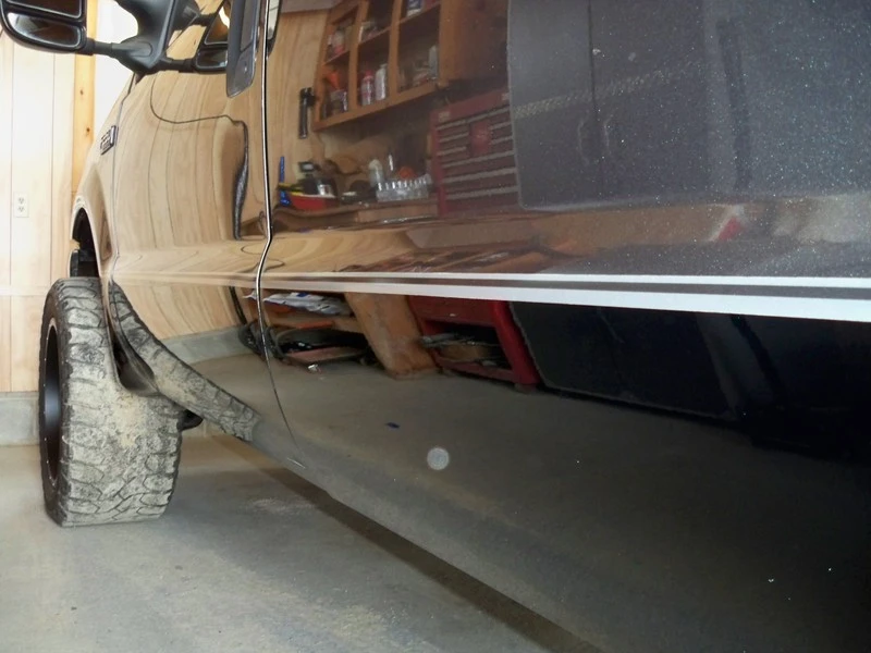

fantastic job! im impressed with how the bottom of the doors look seeing how much those tires stick out. good looking truck.

A lot of that black looking so good is the pictures I selected to show. There's plenty of rock chips right behind the front tires, but it's not nearly as bad as you would think.
I went speed 6 on the first two 105 passes, and 4.5ish on the 3rd pass. On the polish, I was around 3.5 or so. Honestly, I think you could get away without using the 205. If I would have slowed the last 105 pass down just a bit and lightened up the pressure, I think it would have finished out perfectly. I definitely think that's the way to go if someone is paying you to detail it. Would save an entire pass over the vehicle.
