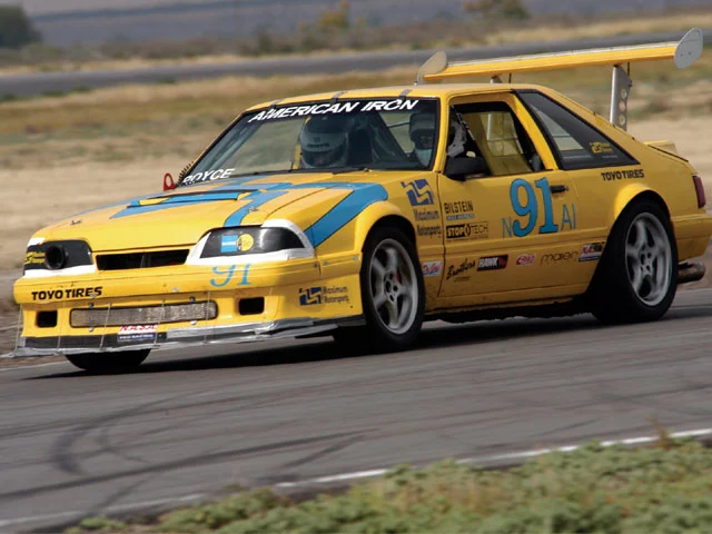

yup i had a long talk with Jason at MM about it, as long as the car is dampened and properly lowered its not a bad thing i have Bilstein MM3 race shocks and struts on the car, remember this is a 90/10 car 90% track 10% street, im not sure if you are referring to coil overs or regular style springs
heres a pic of MM shop car in use
and here is steves car

notice how low the cars are, about the same as mine, im not arguing im just going by what Jason has talked with me about
Yup, I have talked to Jason alot too, but MM always tells me that lowering a car more than 1.5" kills handling no matter if you are running coilovers or regular springs. Maybe they are referring to street cars IDK. My car is 100% street on a full MM setup (minus the tq arm which I have yet to install) with Bilstein HD's & 350lb & 250lb coilovers. Its not as an aggressive setup as yours, but it is about 2 1/2" lower than a stock Mach 1. IMO, the car doesnt really handle that great, but maybe mine isn't setup properly IDK?
The Yellow MM car in the pic doesnt look as low as yours does IMO, I can still see a gap above the tire...
