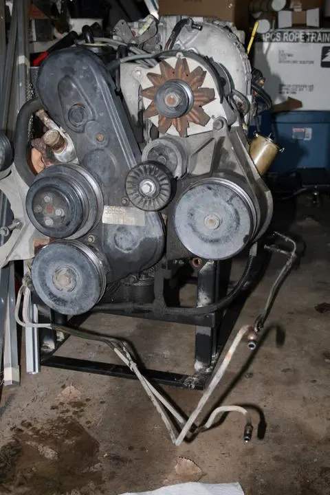

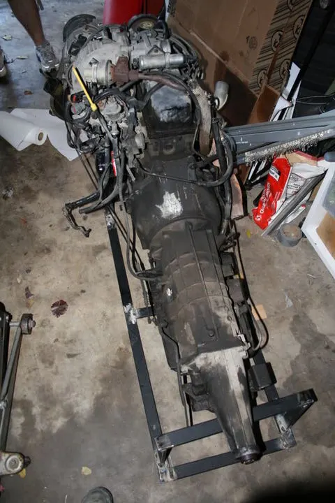

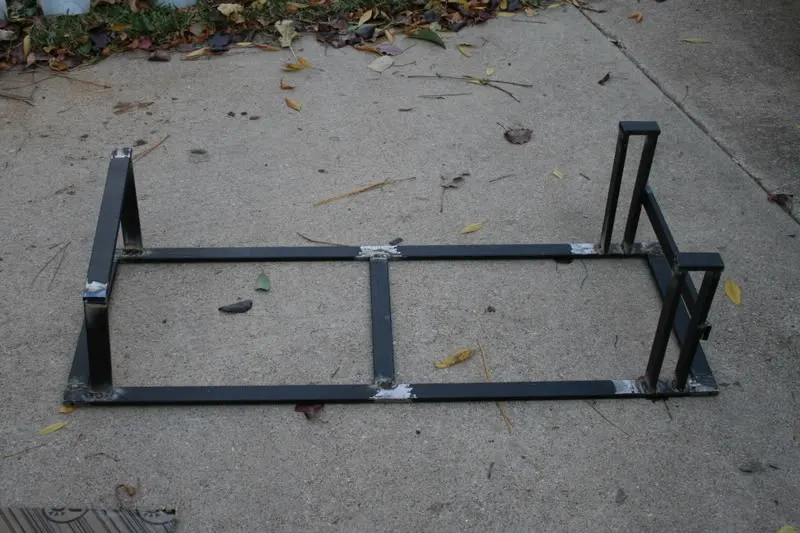

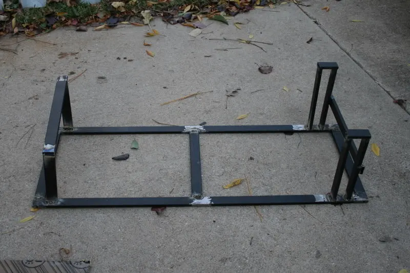

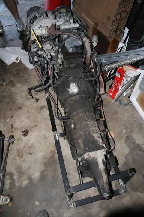

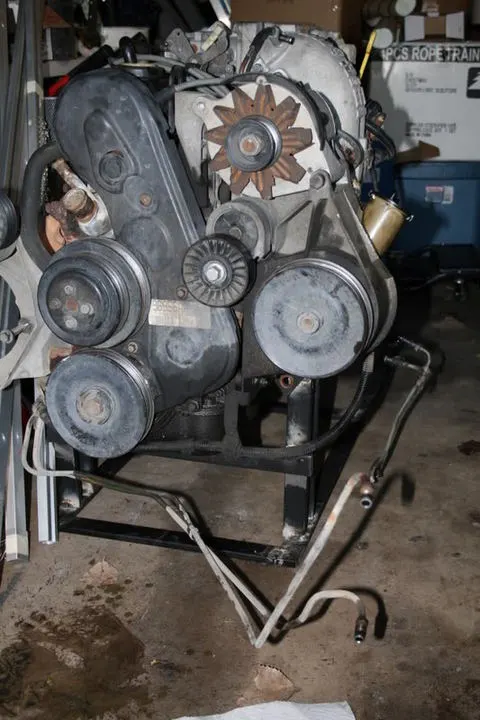

here's some pics of the stand I welded up
mike

That stand looks sweet. This is a perfect example of why i need a MIG welder for Christmas. I bought a custom stand off of EBay a few months back for my spare 2.3L. A guy up in Towanda, PA welds them up and sells them for about 30 bucks. Honestly, what you made is better since it handles the engine and transmission.
