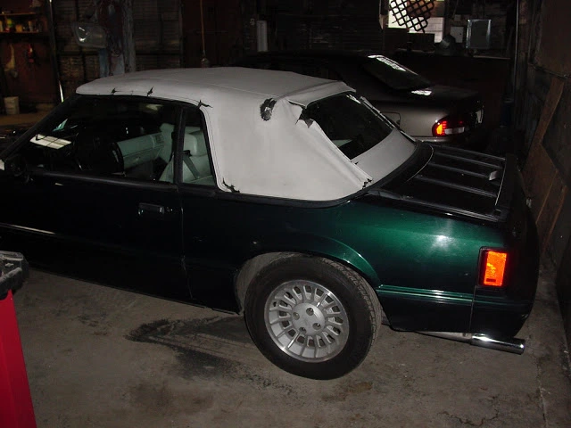

I'm not sure how much prices have changed since the top was installed on my Vert. But the receipt that came with the car showed it was over $1,000 with tax and all. That was about 5 years ago.
Most shops told me anywhere from 1000-1800 for a new top and install. I had a hook up on installation @300 and an ebay two piece top with glass rear window for around 350 plus weather strip, total was around 800. That was about 2 years ago.
By the way, this is why I replaced mine :notnice:
When I bought the car
I had the same problem, even with all those "relief" areas, when it was cold it would stop about 10" shy of the windshield.
Now
+1 on window guide bushings. Not expensive, 5.0 resto has them. Once you find the bolt on the bottom of the door that holds the guide rod in place they are not horrible to change. If the windows are tinted use something to protect the tint (I used a file folder) while you wrestle the guide out or you can scratch up the tint. Why don't you buy your wife her own car?
I have heard nothing but bad about trying to replace the top as a diy. Anyone try?
I've heard it can be done, but if you mess it up, you have to buy another new top. A buddy of mine did his wifes vw rabbit one piece top in a day with another friend. But I don't know if it's worth risking double the money for the possible savings. And since it's your wifes dd she'd be really mad if she had to go to work without a roof :nono:
If I were to try it, I would do it with a blue tarp or something that won't stretch to use as a template before I started cutting my new top.
I did mine last christmas with my wife helping me it took us about 6 hours over two days (the first time I have done this). It's was not easy but at the same time it was not difficult just have to be patent. I learned that after my wife and I got into a very "heated debate". I got mine off of ebay for around 300 and the people selling it sent an install guide and answered all my questions when I called them. I had to replaced mine after some kids ripped it open to steal my $40.00 cd player. It probably doesn't look as good as a professional job but it saved me about 1000 so I was okay with it. Here in Arizona most of the time I drive with the top down anyways:D
