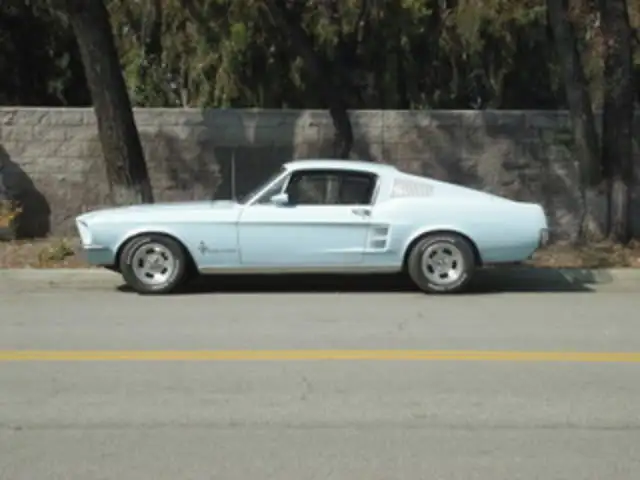

I have the 620's with 3/4 of a coil cut out on my 67 with a 351W.
Too harsh in town but somewhat tolerable on the freeway.

Me?
CraigMBA said:
What shocks do you have? KYB
What tire pressure are you running? 30-32
What tire size/type do you have?
P215 60R14 on ol' school slotted mags
Looks like this, but with newer tires...
Sorry for the blurry pic.
