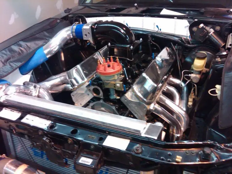

Big bore 347, AFR225, 76mm ball bearing...

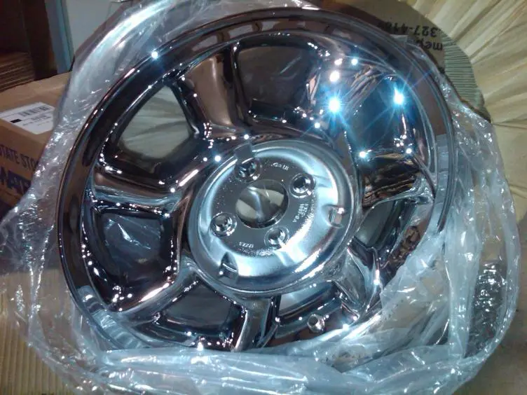

I sent the stock wheels out to Classic Components in CA to have the factory 93 Cobra wheels chromed...very nice!

Very nice, any more info on the setup?

nice setup, 1k hp on pump gas ?

That thing is gonna haul The wheels look awesome. If you don't mind me asking, how much was each wheel to chrome?
I'm going to make as much power as I can through a 60# inj, it's a street car and I'm just going to tune it with a SCT. If he wants to upgrade inj and a EFI system, well go 160# and go for broke...lol
Seeing Lukes car make 973HP in Dave's thread give me hope that is car is capable of much more, the motor is a lot more aggressive and it has a nice street solid roller set-up.
For 4 17" wheels including shipping back they start at $700...I didn't think that was bad, show chrome, warranty....they did the Stainless centers as well.

Flavadave4 said:
Very cool, I am interested to see the rest of the car.
Ill have to get some more pics, it's a 45,000mile previously unmolested 93 Cobra. I have put my own fuel system in it, using a BBRC alum tank, Aeromotive, etc, fully built rear with 9" ends, Eaton Posi, Moser axles. The only hint from the outside of what is lurking beneath is a 4" cowl, otherwise it looks scary stock I'm going to leave the exhaust alone with a 3.5" Bullet, being a turbo it should be fairly quite.
The car will have the complete front accessories, minus the smog pump, the A/C was a challenge but with some custom braided lines and some components I was able to get it all to work out.
This car is a true sleeper, for a NFL player on the Baltimore Ravens. I get to put the first 600 miles on it, can't wait to drive it
