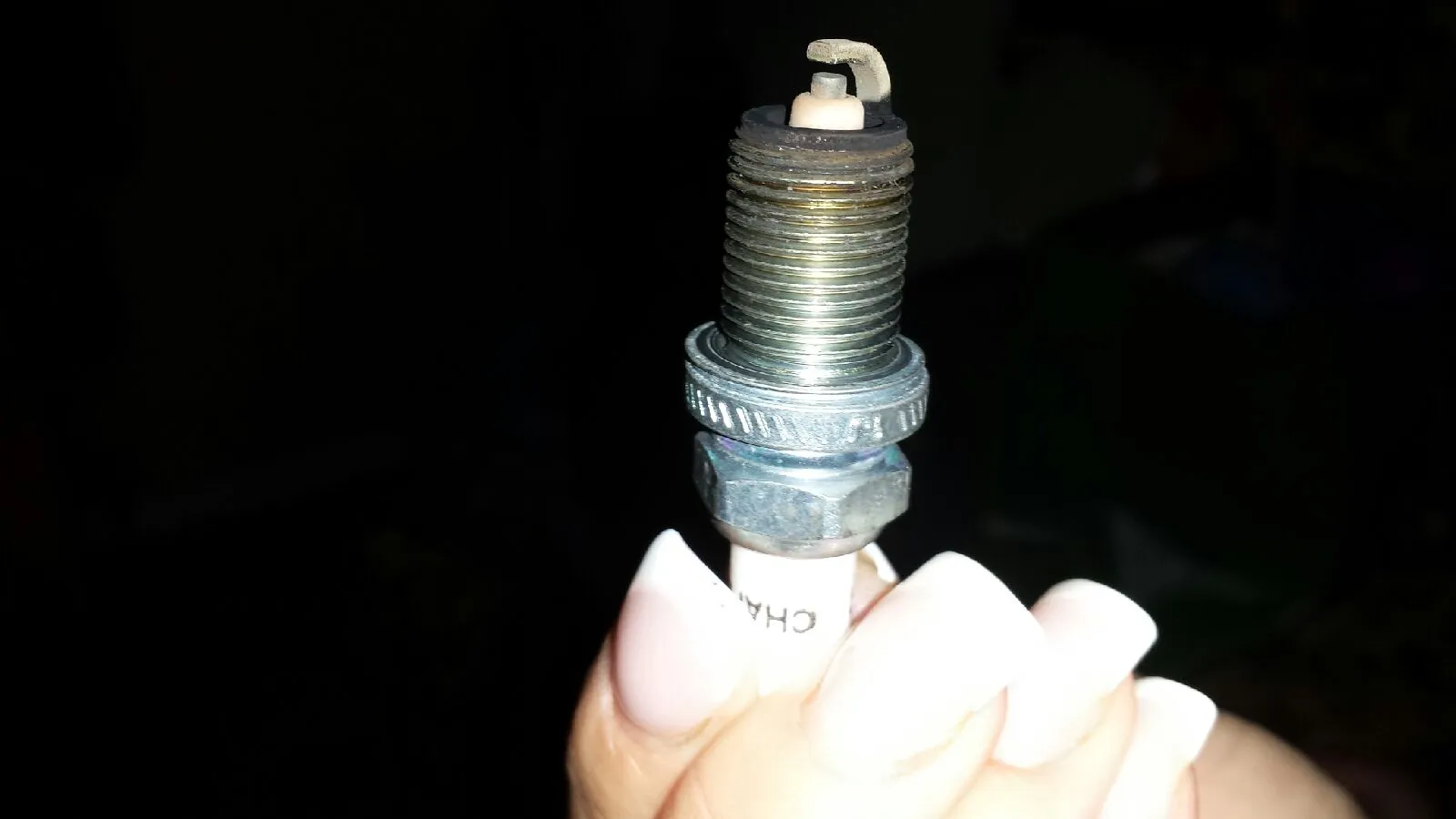

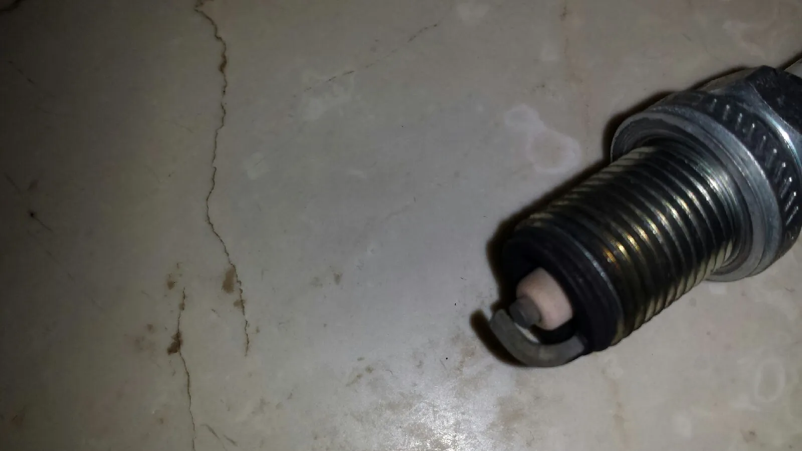

I pulled one plug this is what it looked like...also there champions RC9YC im not a fan of them the shop installed them..what is a good plug to use with Trickflow 170 cc heads.I also run a snow performance meth kit too....

You said they look fine not lean? i know there clean from the meth injection..wonder if the meth is doing something to them???
I agree...Now like i said i have had the car together for over a yr Never had this issue...Only started after the water pump and electric fan install...Question does the gap open up after time..Meaning is it possible they were gapped smaller and with heat etc...the gap open up some????
yes, the gap opens as the plug wears. Throw a gap gauge on em, what are they reading?
.o30 on the 2 i pulled out, so now im thinking is it possible they had them closed up more and there just wearing and i could have fouled one with the weak spark and im noticing it now more so??? there a yr and half old and i run 14 psi...and i drove the car alot...didnt beat on it so much but drove it daily...
