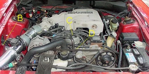

follow your maf wires to where they enter the fender. the spout connector will be hanging in that wire harness on the outside of the hole where maf wires enter pass side fender...
SPOUT LOCATION IS LABELED (B)
PICTURES COPIED FROM: http://www.muscularmustangs.com/maintain.php

So first I mark on the balancer what I want it at (10*) and then disconnect the spout connector, then I loosen the dizzy and then I start the car and turn w/e way till I see the mark solid and turn car off tighten dizzy connect spout and start again and check?
