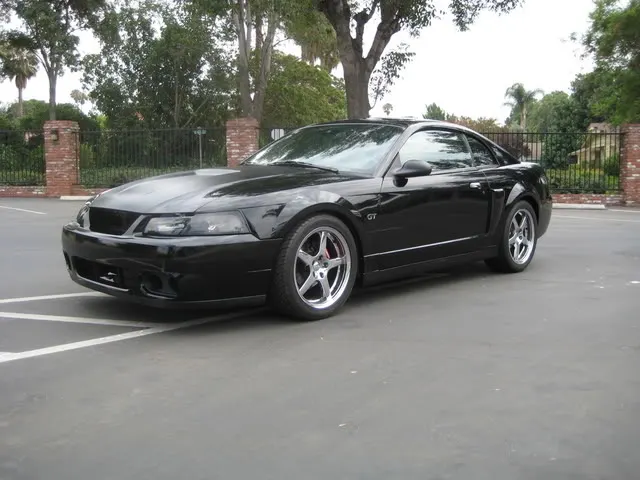

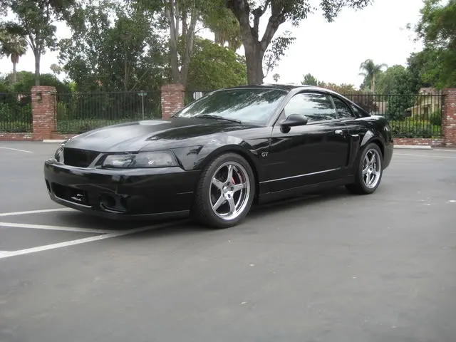

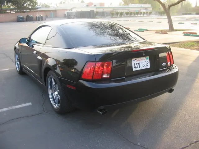

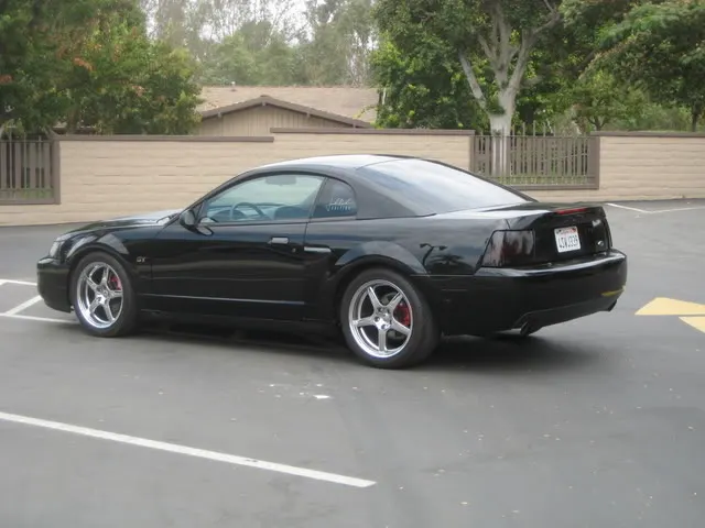

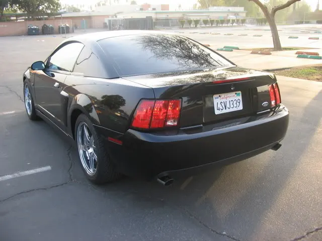

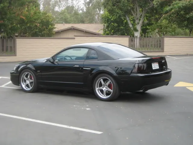

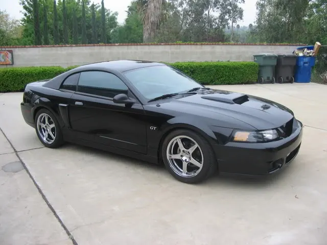

I was able to do my rear side reflectors and taillights with 1 can of VHT Nightshades. The Key is to make sure that you go over the lenses with a few clear coats. Otherwise they just look hazzy. I didn't do the front headlights. I went ahead and bought some smoked clearcorner headlights off ebay. I was very happy with the way they look. Here ya go...
Before
After
