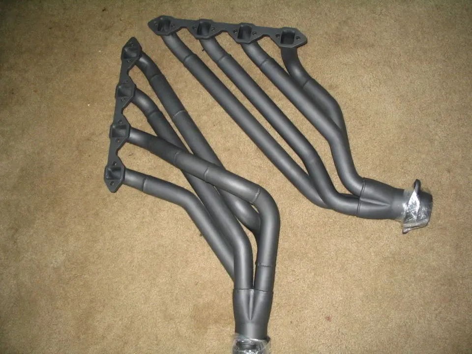

these are FPA's for my 351W. they were made with rectangular ports. (not overly impressed with these headers though).
You don't want the header openings to exactly match the ports. It's best for the headers to be slightly larger to reduce reversion (exhaust pushing back into the engine during valve overlap).
Quite true, something that's mentioned in the link I posted. Even the factory manifolds accounted for this, due to the chance of slight movement of the manifolds before the bolts are torqued.
