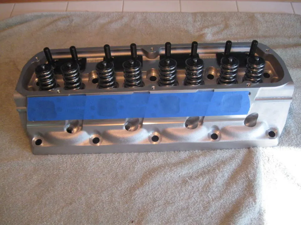

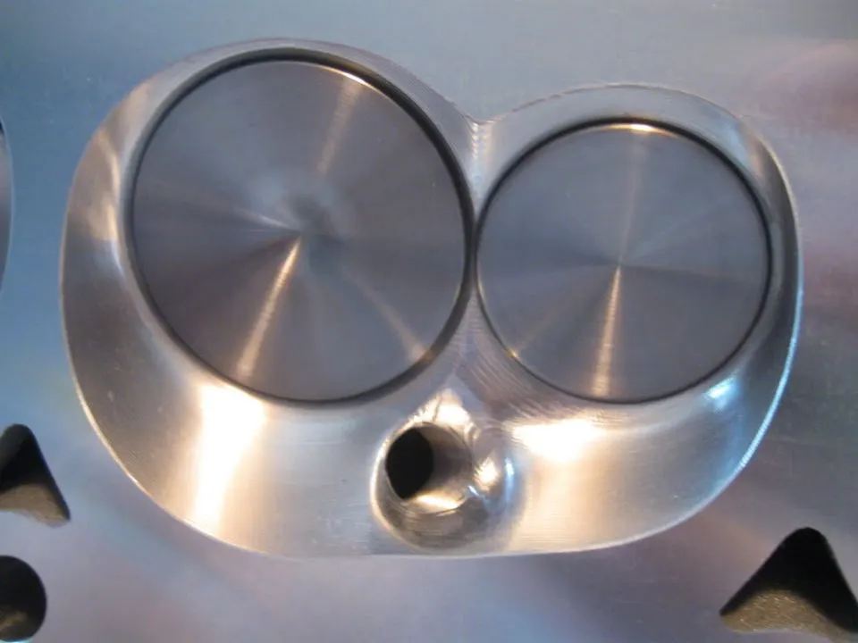

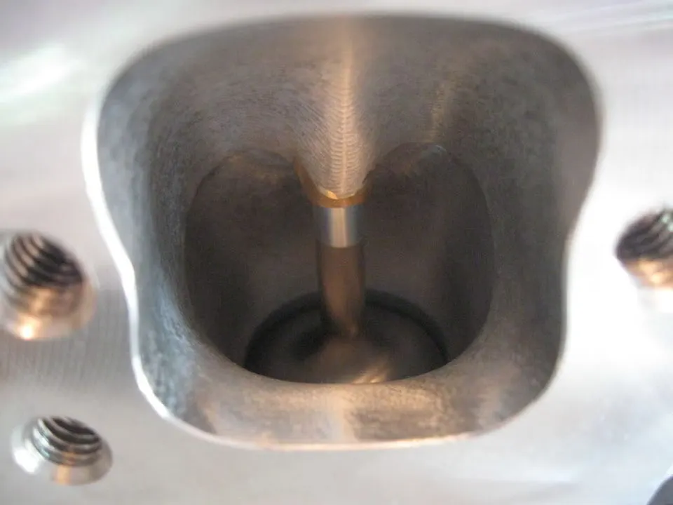

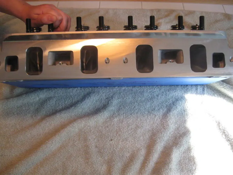

One of Bryans fellow co workers stopped by today and dropped these off....
Here are some long awaited pics of the new heads.
As far as some more info on the heads here are the flow numbers.
Lift Intake Exhaust
.100" ..80 .58
.200" 142 115
.300" 196 150
.400" 258 190
.500" 304 215
.550" 320 220
.600" 333 222
.650" 340 230
.700" 334 236
.750" 340 238
The heads also use 5/16" valve stem, not the standard 11/32" stems. These valves are over 20% lighter then the competition. As quoted by Ed. He said this valve train with the correct push rods will spin up the lower 7K range. They are also 64cc Combustion chambers.

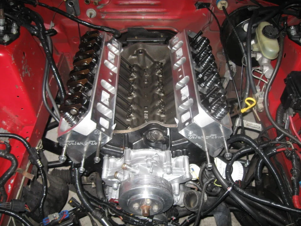

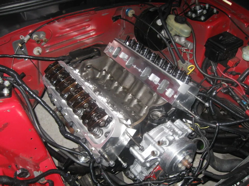

Putting the roller rockers on the drivers side monday. Should have the top half assembled next weekend. Have to get an intake gasket to fit around the huge ports

Engine is going to be looking pretty sweet when its back together.
