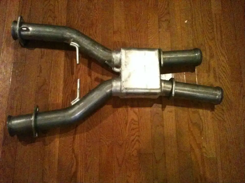

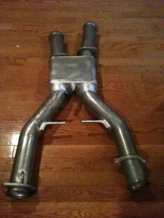

Well this came in today, Hope it bolts up much easier then the headers to the heads are. If it looks a little more beefy its b/c its 3"

wow Travis you've put a lot of parts into the car in the last year.

I had to get a new mid pipe anyway b/c of the long tubes. I'm dealing with more issues then progress at this point

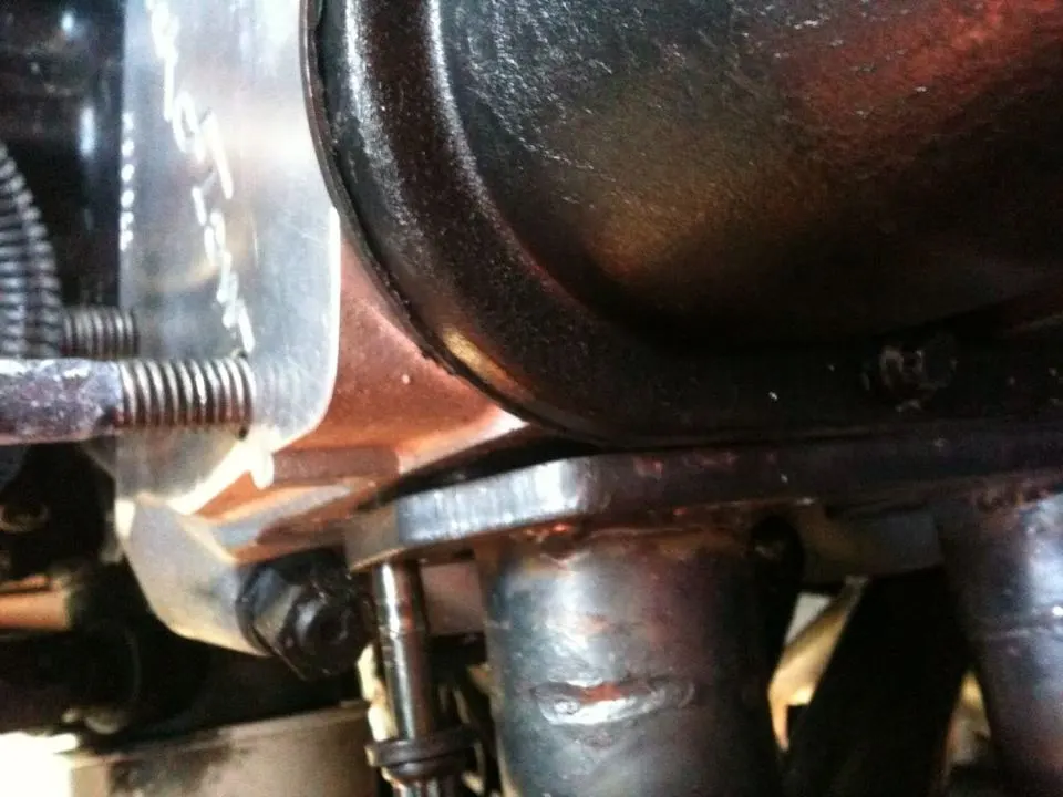

I will fred I have not forgotten about it . The most help I will need is when everything is ready to be installed. I did resolve one issue. The bolt holes and header flange bolts would not fit the ARP head studs I had or the percy locking bolts from the other headers that came with the car. The bolt holes on each were to small. Sent an E-mail to ed curtis and found out the bolt hole size that those heads actually use are 5 /16th and a chrysler SB bolt size and not the standard Ford 3/8 bolt size.

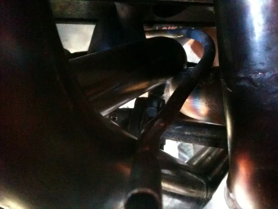

I'm hoping that by unbolting the tranny mount I'll get a little more twist out of the engine and be able to slide the passenger side header up in and I'll have to get a flaming river steering shaft to resolve the fitment issues on the drivers side.
binding up on the steering shaft
